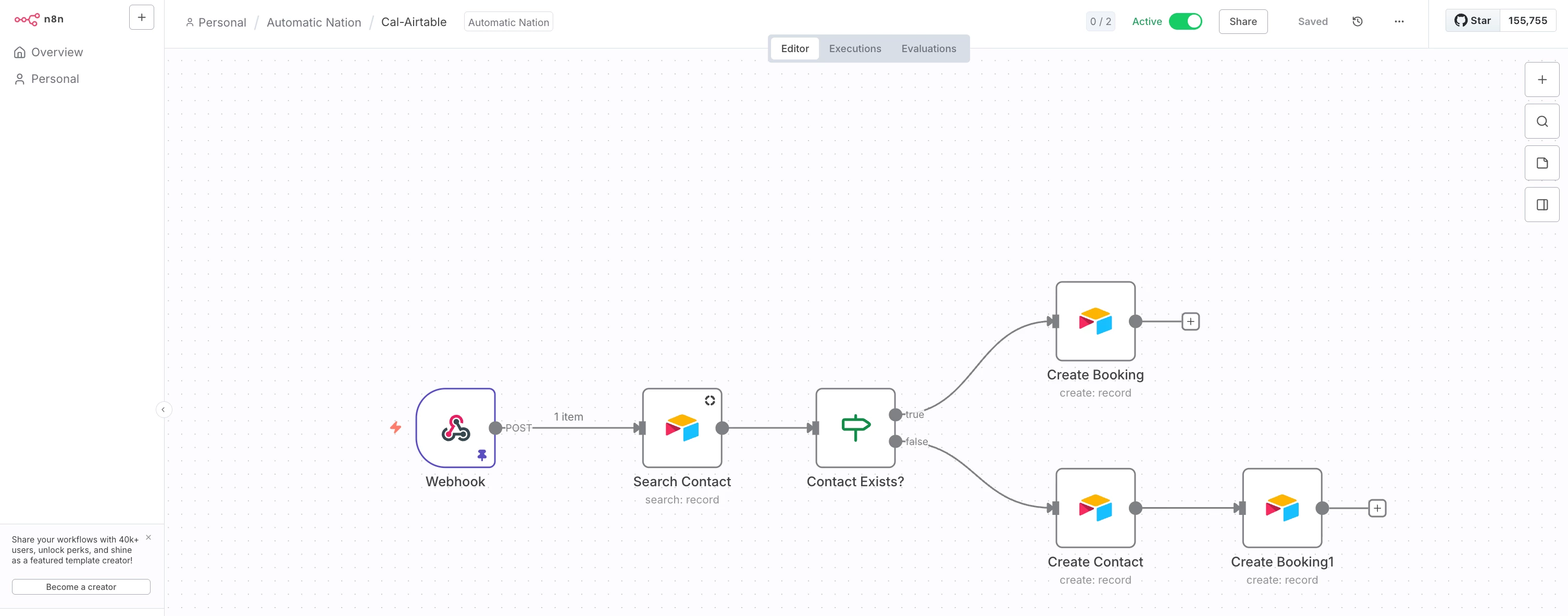

I’m having a hard time to follow through the description of the issue. However, when dealing with bookings I would highly suggest you rely on Calendly or Cal, where the scheduling will occur.
Then, via webhook and Make, n8n or other automation tool, you would create or update the corresponding event in Airtable.
A simiple version of the above looks like this:
Using calendly or cal you can have your webhooks triggered upon new bookings, reschedules, and cancellations.

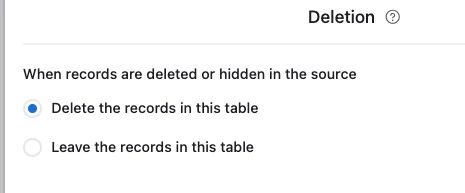

Secondly, so many of the calendar meetings are canceled or deleted. I want Airtable to follow when that happens, but also snap back live on the calendar if it is brought back into the calendar.
When a calendar event gets deleted on Google Calendar the record also gets deleted from Airtable.  You can update this via the sync settings:

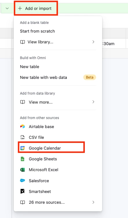

I’m assuming you’re syncing your calendar via the Add or Import table and a Google Calendar though.  Could you confirm how you’re syncing your calendar?
