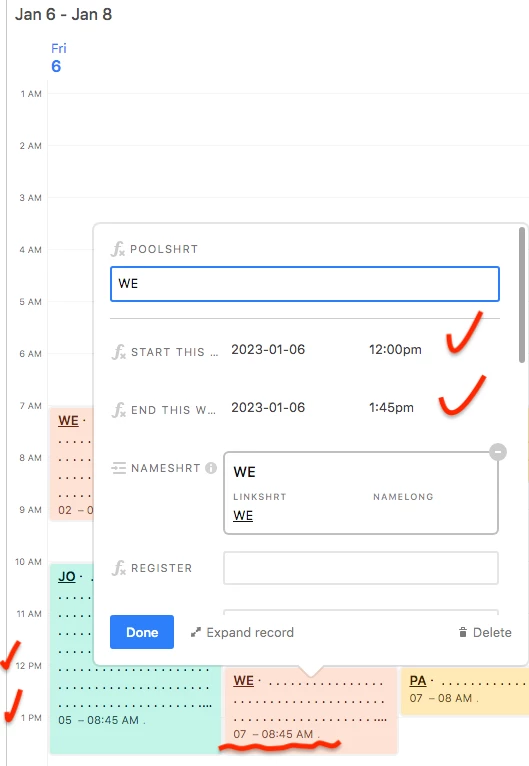

How can I change the date showing in the calendar slot. The time shows correct time zone but the calendar slot shows wrong time zone (I believe it is GMT time, for me minus 5 hours).
I played around with time zones so I know it can get difficult to get it to work correctly but that is not the issue. The field shows correct time zone.
The calendar slot is also correct.
Only the bottom of the time slot shows wrong time zone. This is not my field, it seems default field shown by Airtable and I can't disable it. Not sure where comes from.

Thank you for putting this together. I looked into the time zone in system preferences it shows correct time zone. However, today I looked at the calendar and the issue is gone somehow. Don't know, haven't changed anything.
I have the same issue. I checked my time zone on my computer and it is correct. But all my available time slots are displaying in GMT.
OK, I found the answer through a message to support. You have to edit the time slot records.
When you edit your time slot field, you can select whether to "Use the same timezone (GMT) for all collaborators."
