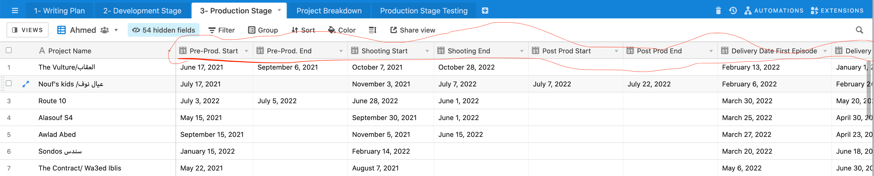

I have a client that I am working with: has a content production company and they have their production timeline split in phases like Shooting , Pre production , post production and Delivery with start and End date like this:

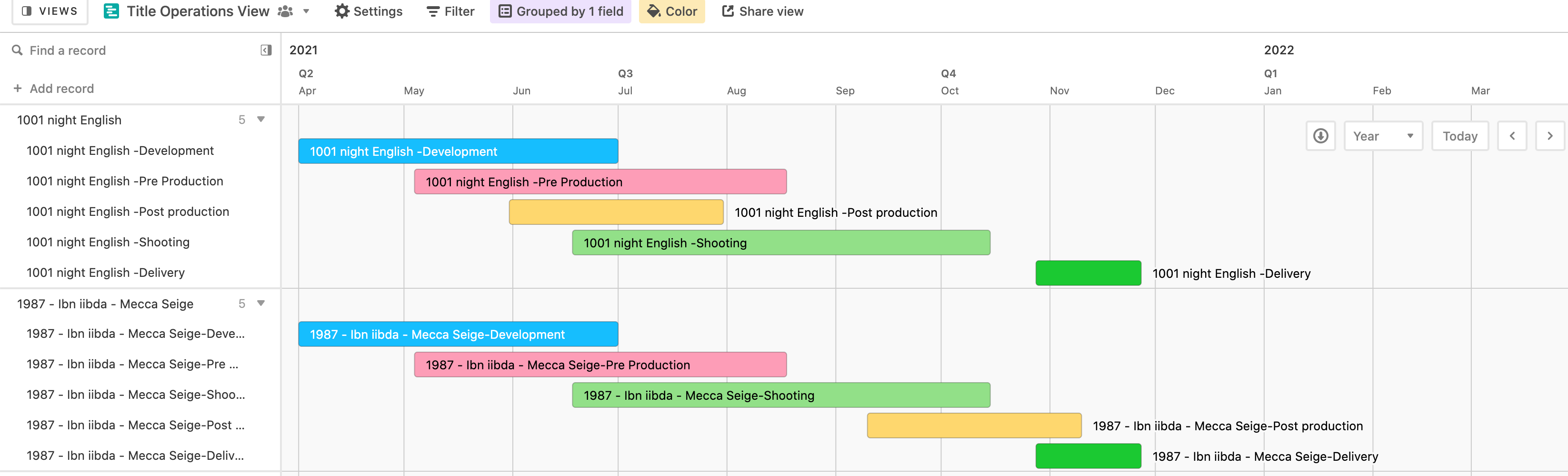

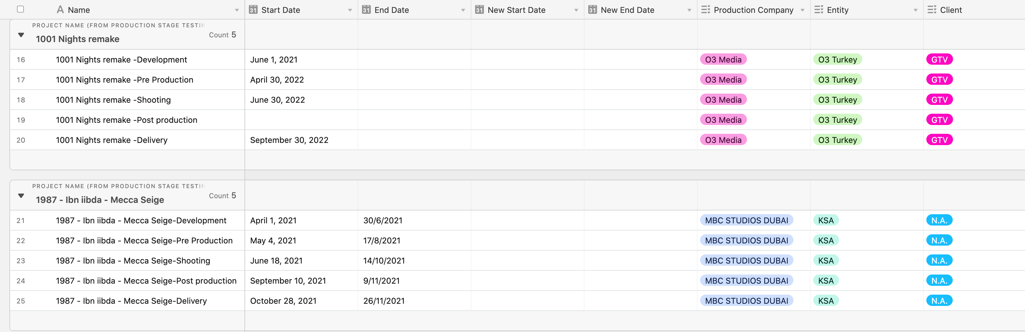

What I want to do is to break it through into separate unique records so I can group them together in a Gantt chart and able to see each phase inside the same project like this
gird view :
Gantt Chart view
Is that something I can automate if I have all dates starts and ends in one record , that would be great to automate , because they still want to use the same structure and not to break it down to this as insertions .Thank you guys for your assistance .
