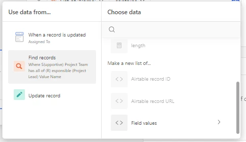

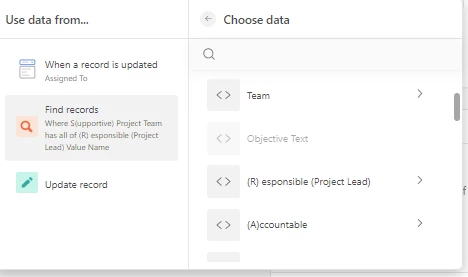

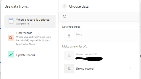

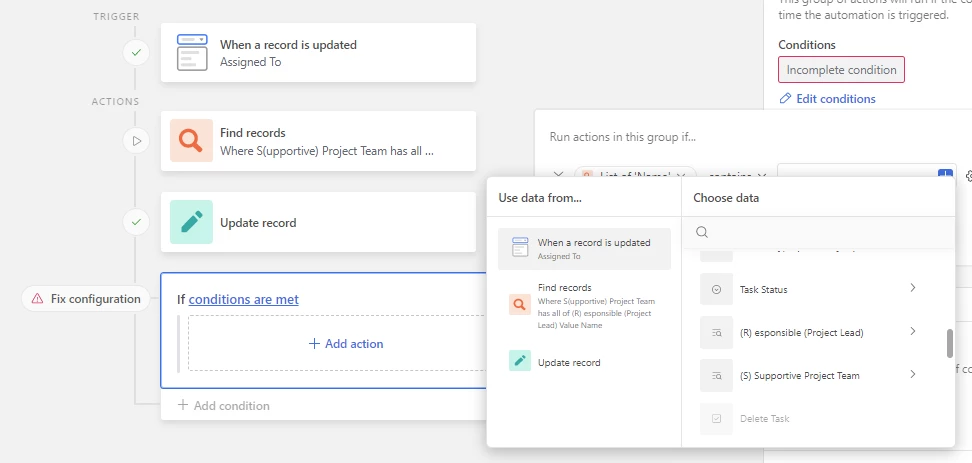

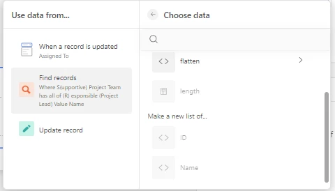

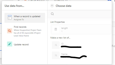

First, I want to make sure to update the project team with the "assigned to" names and simply not include the Project Lead.  How do I set it up to still update but only with names that are not the project lead.  Multiple steps?
Do I even need a find records?
I have not used conditional functions for automation yet, but trying now.  I find they can be confusing when figuring out where to pull the info from (which previous step) and also what to link it to.  I am having an issue with grayed-out options when trying to connect dynamically, and I assume it has to be due to the data string since the Project Team is a multi-select. If you're still with me, see if the screenshots make sense.  What is the best workflow? Remember, I still need it to run even if the project lead is on the project team and simply only move over any new people, omitting the Project Lead.
Let me know if that makes sense.  Thank you!
