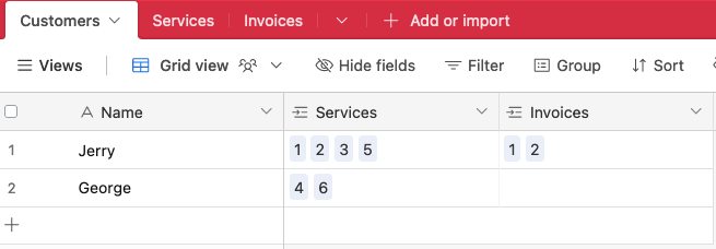

Yeap it's possible!  Here's an example of how to handle it.
You'd have a "Customers" table that contains all your customers:

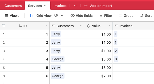

A "Services" table where you note down the service that was provided, to which customer it was provided and how much it cost, etc

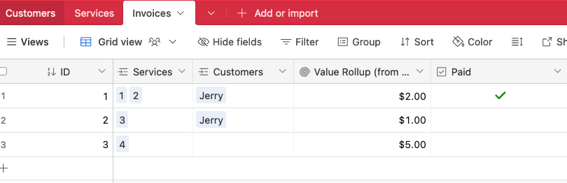

An "Invoices" table where you would create each invoice whenever you wanted to bill a customer
You could then create multiple "Service" records, and at the end of the month, create "Invoice" records for your customers, and link them to the appropriate "Service" records.  The rollup field would display the total amount billed for that invoice, and you could then mark the "Paid" checkbox once they've paid
