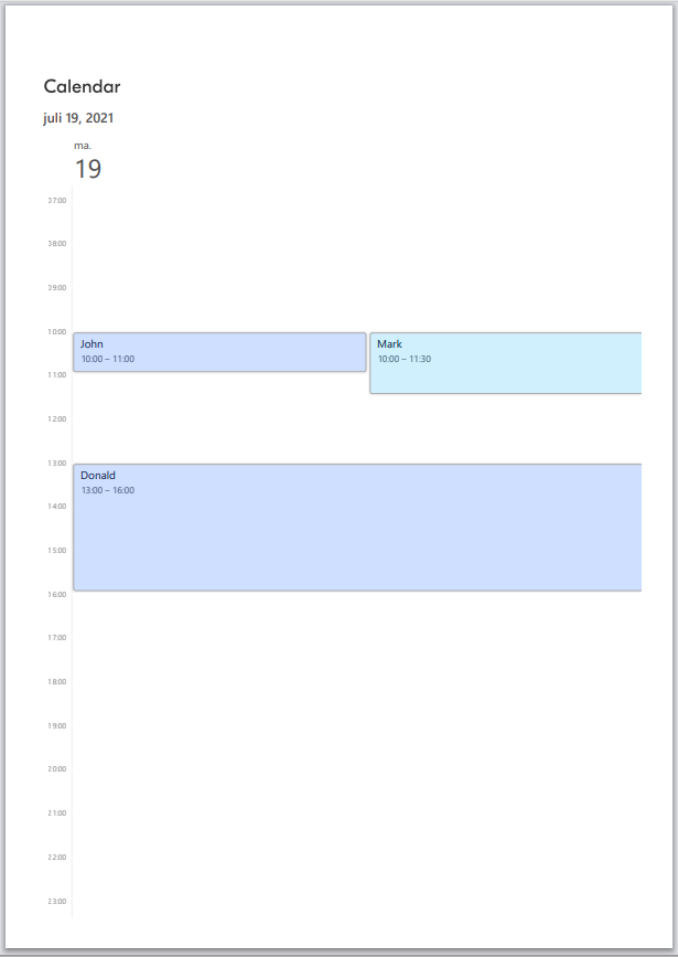

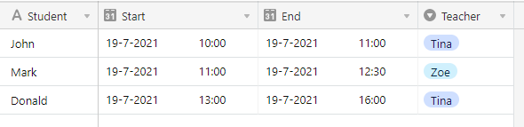

Hi @Yossi_Goldblatt and welcome back!
You could make something like this:
You can then make and print the calendar view. It looks something like this:
Every item only shows the first field, so you could adjust that one by concatenating, and/or you could work with conditional color (eg, per teacher) for better visualisation.
You could also take a look at the Scheduler app from @Kamille_Parks.
Of course, depending on the number of students and teachers involved :slightly_smiling_face:

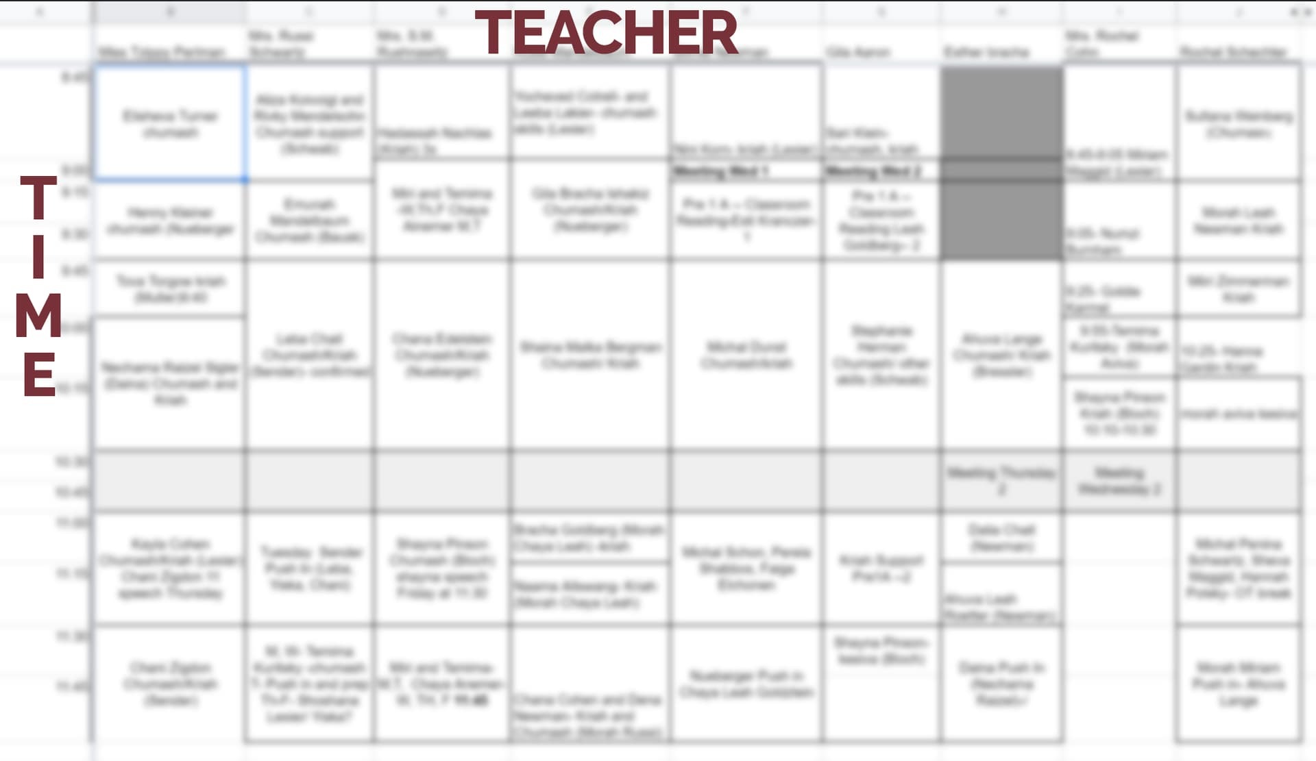

It’s a combination. See screenshot below of current google sheet - super simple and easy to use. I had to blur names for privacy reasons.
This is easy to print, easy to read and easy to change.
Is there any way to replicate this as close as possible in Airtable?
I have tried the Matrix app but you can’t resize the rows or print.

While it’s awesome that you’ve found a use for Airtable in your work, there are many things about that spreadsheet design that can’t currently be replicated in Airtable:
  • Dynamic row heights. There is a single setting in the view toolbar that applies a given height to all records.
  • Merged cells. Airtable isn’t a freeform grid. Each row is a record that’s independent of every other record, and each field is part of that record. Fields aren’t independently-designable entities like they are in a spreadsheet, which also explains why you can’t do…
  • Individual cell coloring. Airtable’s only record-coloring features simply applies a colored marker to the left of each record. Background colors can’t be customized.
To clarify, these formatting options aren’t possible natively. There may be third-party tools that can take Airtable data and generate similar output to your current Google Sheets design, but I haven’t played enough with the available third-party tools to know if those formatting options are even possible.
If you’re willing to live without those three items that I mentioned above, then you could probably get Airtable to work for you, but there’s not much to say in terms of how to execute it: make your records (rows) for the time slots that you want, and make the fields (columns) for the teachers as text fields (either single line or long text depending on your needs). Edit the data as needed, and print as often as you like (probably using my print suggestion above so that everything fits on a single page). That’s about it. You’re not really using Airtable’s database-like features in this kind of design, but you apparently need the flexibility to add and edit text at will, so none of these fields can be link fields. Displaying stuff in arbitrarily-sized blocks of time works great in calendar views, but your columns need to be teachers, not days of the week, and there’s currently no other way in Airtable to create that kind of free-flowing design, soooooo…???
In the end, I can’t really think of any “genius insight” to apply here because what you want is spreadsheet-like behavior in a database-like application, which I’m afraid isn’t going to happen.
