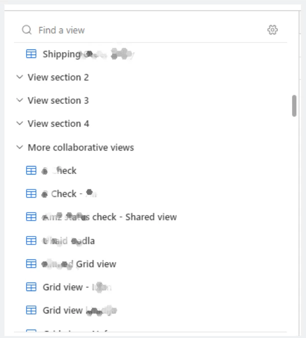

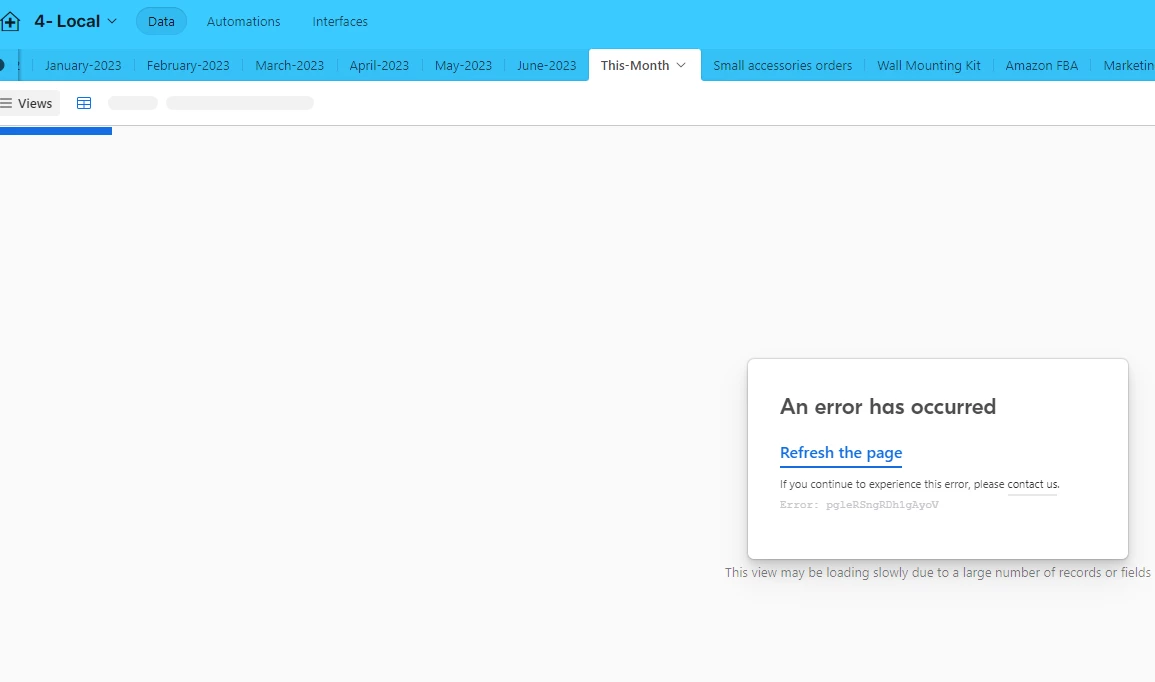

Let me share some screenshots with you. I am working on the same workplace and using the same base, but I must add data month-wise due to the nature of my work.
In the base, there are a lot of people, and each person is using their own view. Sometimes, one person has 3 - 4 different views.
The problem arises when I try to duplicate the month table. It gets stuck for 30 - 40 minutes, and during this time, no one can work on it. Eventually, an error message pops up, and the table is never duplicated.
Your assistance in resolving this issue would be greatly appreciated. If you have any suggestions or solutions, please let me know.

I totally understand how frustrating this must be. I've also faced some issues with long load times and that error code. In my case, the fix was to limit the amount of information in the bases and tables. I suggest some things that could help:
Suggestion 1: Contact Airtable Support and send them the error code you are receiving. Sometimes they will ask for a video of the issue when it's happening so they can try and look deeper into the problem.
Suggestion 2: As I said, the fix to this problem I faced was to limit the information in the bases and tables. The less data, the better the performance. Here are some interesting article that helped me out 👇
