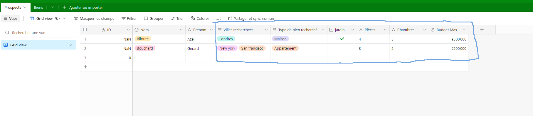

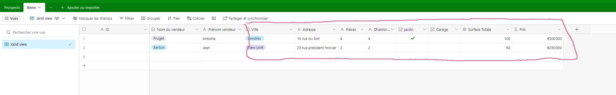

Hello thank you for the feedback,
I don't understand I posted 2 answers with screenshots in this topic but they are not displayed, I try again one last time. In the meantime of course I continue my research,
it seems that the solution lies in a junction table to compare my two tables "prospects" and "products" in order to make a connection.
I try again to put my screeshots, framed in blue and red the values ​​that I want to compare with each other, this to indicate which products can correspond to which prospects. Is it clearer now? sorry it's not easy to explain
Thanks for the help Christophe

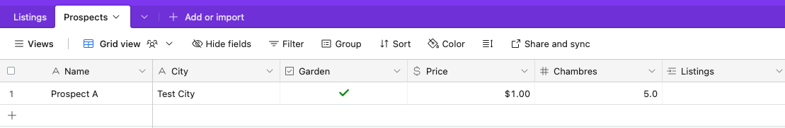

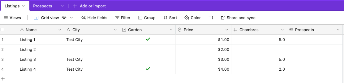

Thanks for the screenshots!  Hmm, I think I don't understand something so I've put something together here.  Once you tell me what's wrong with what I've made I'll see what I can do to fix it
Assuming your listings are like this:
And your prospects are like this:

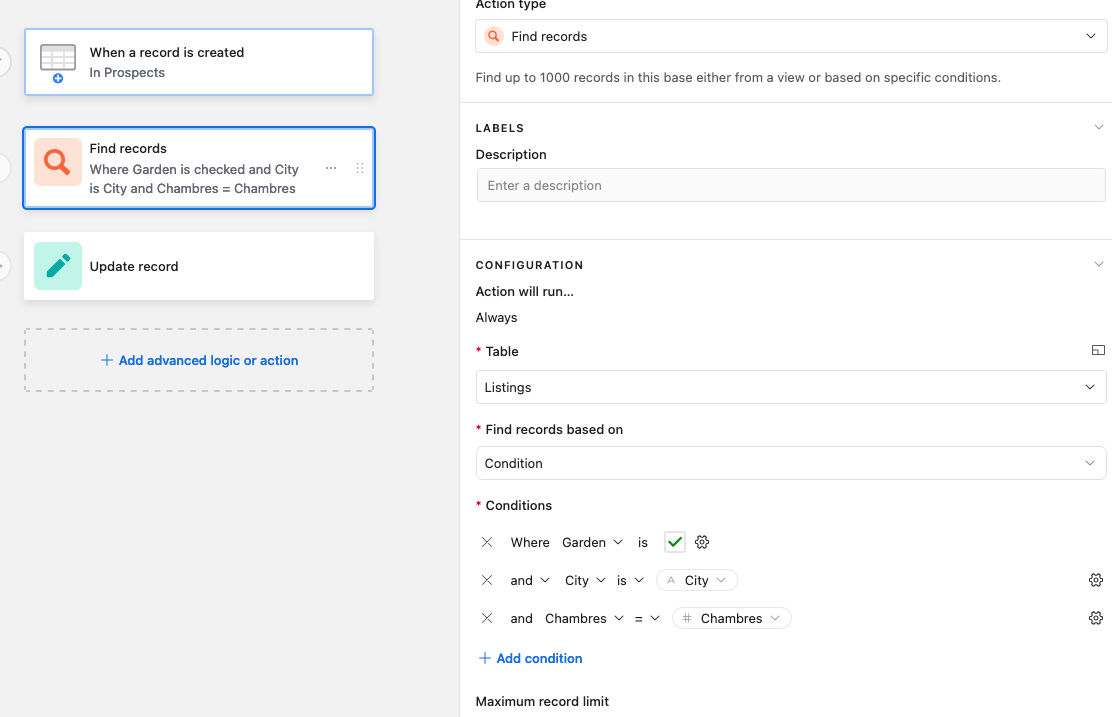

Then you can make your Find Record automation like this:
That final "Update Record" step would be to link the found Listings to the Prospect record
And once this automation looks good we'd make one for the Listings table as well
