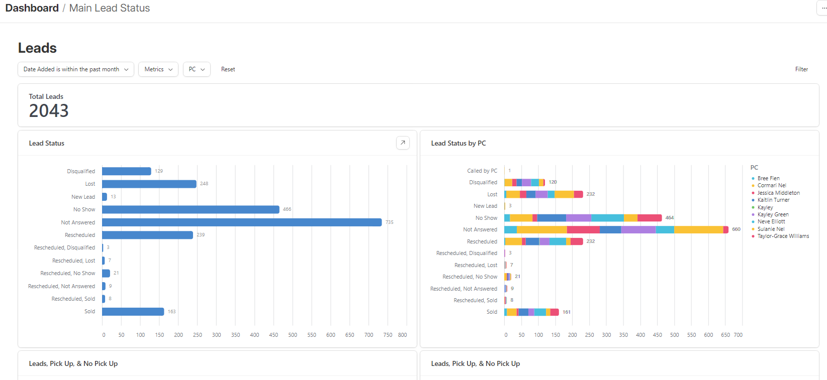

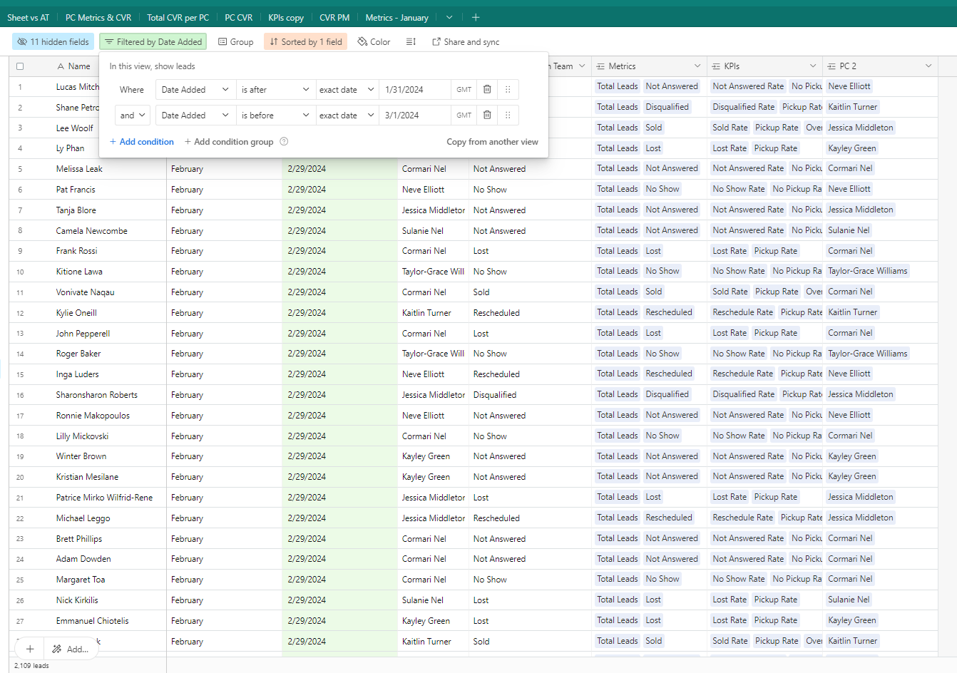

@TheTimeSavingCo This is the Filter for the interface and from the table. As you can see we want to filter it by month in the interface but there is no condition like that in the interface. You can see in the images below that in the interface it is 2044 and in the raw table date is 2109
Hmm, your interface filter is "Within the past month" whereas your view filter is "Is after 1/31/2024" and "Is before 3/1/2024", and that's probably why you have different results
Could you try using the "Within the past month" filter in your view to see whether the results match your interface?  If it does, then you now know which filter to use
