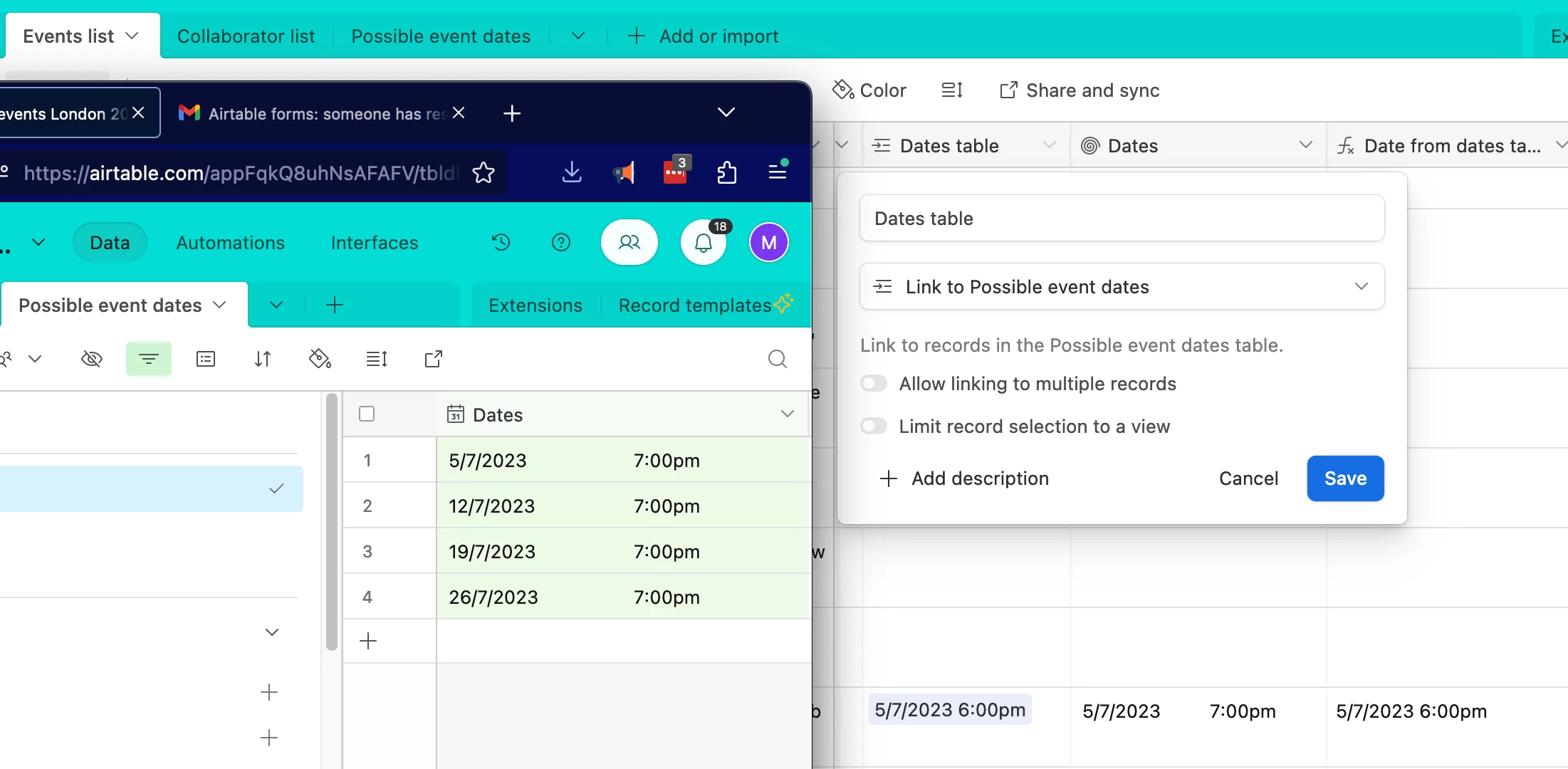

Hi all,
I've got a table of dates called "Possible event dates" that gets linked to other columns including "Dates table" as shown below.
The problem is that the link seems to be setting the time back an hour, as though they were set to different time zones, but it's not clear from the field settings how this is happening.
Any ideas? Thanks!
Best answer by kuovonne
Airtable stores all times in GMT. Would you happen to be one hour off from GMT?
Check the timezone settings for both the original date field and the calculated date field. They probably have different settings.
  • June 23, 2023
