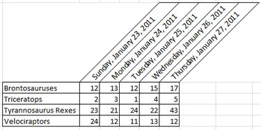

Bluntly, this sucks. Is there a way to have angled column headers so that the column name can still be see in full, but the columns can be made only as wide as they need to be? Something like this:

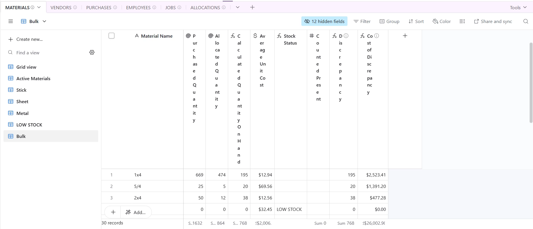

Unfortunately ​@TheTimeSavingCo not so much, I use a 15.7” laptop so I don’t have that much screen area. The result of wrapped headers is this:
 Which then only shows 4 rows of the useful data as the column headers don’t scroll up (which makes sense). If I wanted/needed wider columns it would do. However since most of the data I need is only 2-6 digits of numbers the columns can, and for readability should, be very narrow.

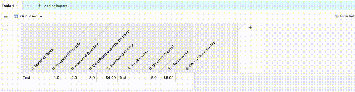

This was really interesting to me so I tinkered a bit to get a Userscript working.  It looks alright but it’s pretty clunky.  Could probably iron out more of the issues but eh, this works.  I tried to get the spacing of the ‘Add new field’ column to dynamically update but gave up after a bit
The vertical lines between the headers are technically still there, just hidden, and so to resize the headers we’d need to click on them
To install it you’ll need to install a Userscript manager (such as GreaseMonkey, ViolentMonkey, etc) as a browser extension and then load up the following script.  Let me know if you have any issues with installation or with usage and I’ll see what I can do!
We can make this apply only to specific views by updating this part of the script:
// @match        https://airtable.com/appxOc1MJKEFInsW5/tblatsc5wCwfrpMi6/viwVmnIjaaPt2SrQE
And we’d just need to update the app ID, table ID and view ID
On the off chance you want it to apply this to all views in a single table, then we would add an asterisk after the table ID like so:
// @match        https://airtable.com/appxOc1MJKEFInsW5/tblatsc5wCwfrpMi6/*
