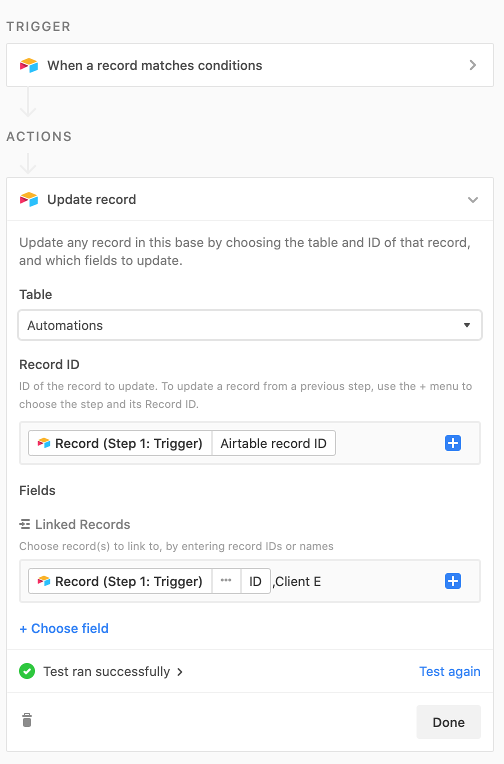

There’s no direct way to do this, but you could do it with an automation that uses the action to “Update Record”.
You can append a new linked record to an already-existing linked record field by: (a) inserting the existing field, (b) adding a comma, and then (c) typing in the new value.
It would look something like this:
The only thing that you would need to figure out is what would trigger your automation to run.
Alternatively, you can also do what you’d like to do with a custom Javascript, a custom API call, or using an external automation platform like Integromat.

Thanks Scott, I was hopping it to be a bit easier, but you definitely shed some light on how to solve it.
I am thinking about this.
  1. I create a new column (“NEW CLIENT”) with the client name I want to add
  2. I create a new column that concatenates the original column with the new clients column
  3. I make a new view that is only filtered in those cases where new client is not empty.
  4. I made an automation, where every time I a new record enters that view, the content of the original linked records is updated with the the content of the concatenated column, therefore adding the new clients record to the previous ones.
:heart_eyes: :heart_eyes:

Yes, that will work too! :slightly_smiling_face:
