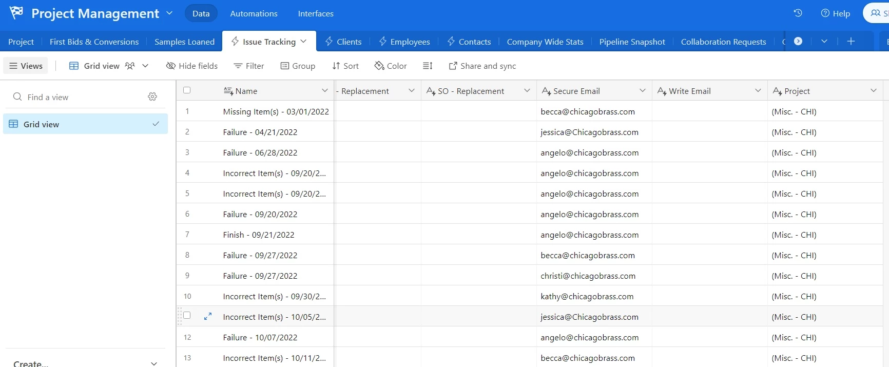

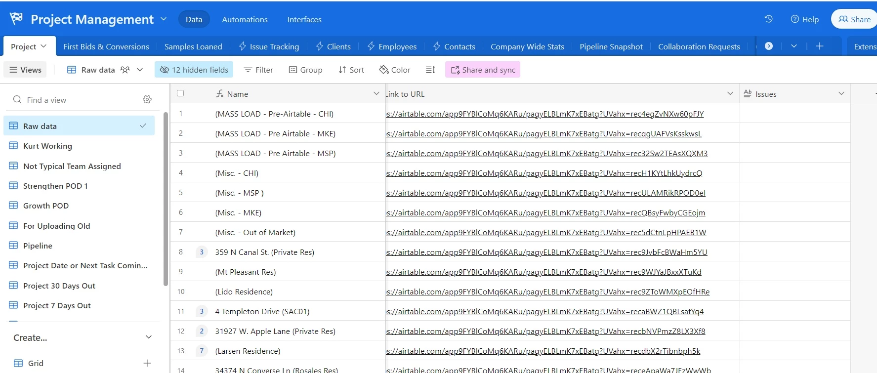

Stepped away from it for a bit but not back at it.  Screen shots attached.  I tried changing away from formulas for the name.  When I did that it did show up as a linked record instead of text, but then when I added a project (base 1 record) to an issue (base 2 record), rather than referencing it created a duplicate of the base 1 record name.
