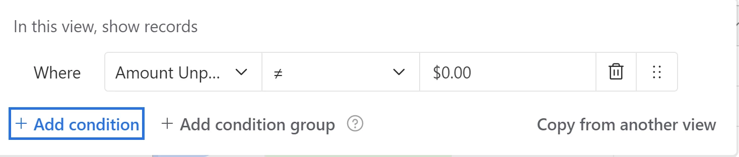

My filer is not working as expected.  I am filtering on formula field.

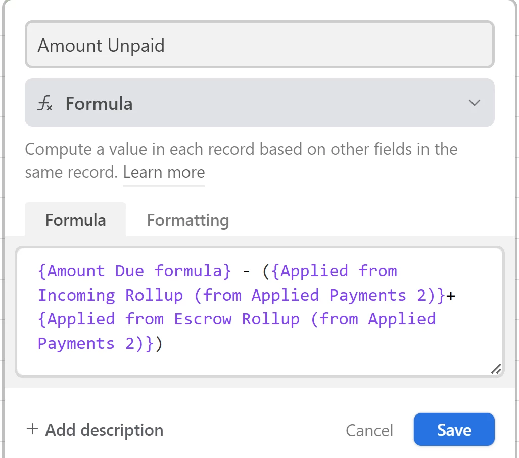

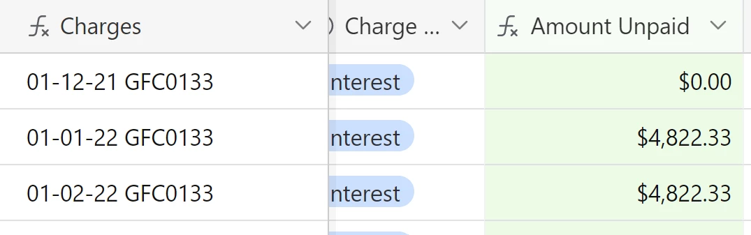

The goal is to hide paid charges and only show unpaid charges.  My filter is filtering on NOT = $0.00.  Showing pictures of file, results and the formula for the field.

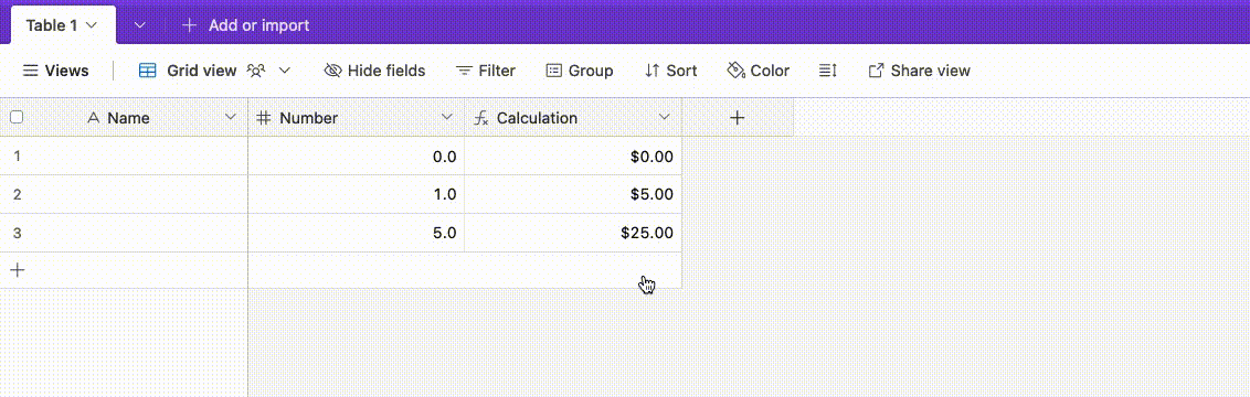

Interesting! Any chance you could share an example base where this is happening or some screenshots of your data?  I wasn't able to replicate this and am very curious about it too

After exploring this, we discovered this was happening as the field was formatted to display as "Currency", which automatically truncated everything after two decimals, and as a result what displayed as 0 wasn't actually 0, but stuff like 0.0001 instead, causing them to display despite the filter!
