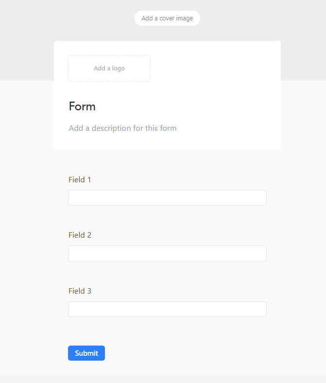

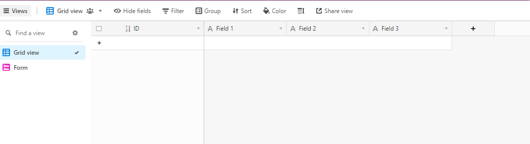

I have a table with three fields with rather generic names:
As expected, when I create my form view, the actual fields names will be the default name displayed.

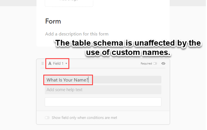

When you click into a field, you'll be able to set the text that you want your users to actually see when using the form.

Hey @isobel_16!
Something that a lot of users don't realize when working with Airtable's Form views is that you can actually override the field name that is displayed in the view without having it affect the actual field name in the base schema.
Here's an example.
