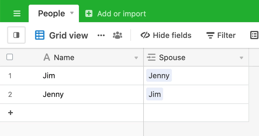

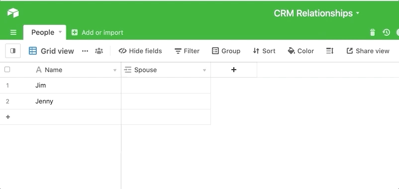

Hi @Marketing_Team - I would recommend option 1 where joint donors are separated and you can track them as individuals. But, to keep track of the fact that they are related I would have a linked column from the table to itself - like this:
What you can also do if you have access to Airtable automations is “complete the circle” so that when you link Jenny to Jim, the link reciprocal link is automatically made:
There might be some work to do on the donations, depending upon how you choose to handle this - single person donations are fine, but for a joint donation, do you attribute this to one spouse and not the other or tag each with half of the donation?

Thank you for such a thoughtful response! We have all of that set-up, thankfully! There are a few cases where we didn’t split up couples because they are always interacting together, but I imagine we’ll still go through the process to split them up soon.
And yes, you’re exactly right about what that means for donation automation. I’d prefer the former option, always attributing it to the lead spouse (and therefore always have a lead spouse). I’m checking with our developer to see if there is a ay to ensure if the donation matches their spousal name, or one of the spouse names, or the name a previous donation was made under that is attached to their record, it always goes to the lead spouse, but I’m not sure if that’s possible!
