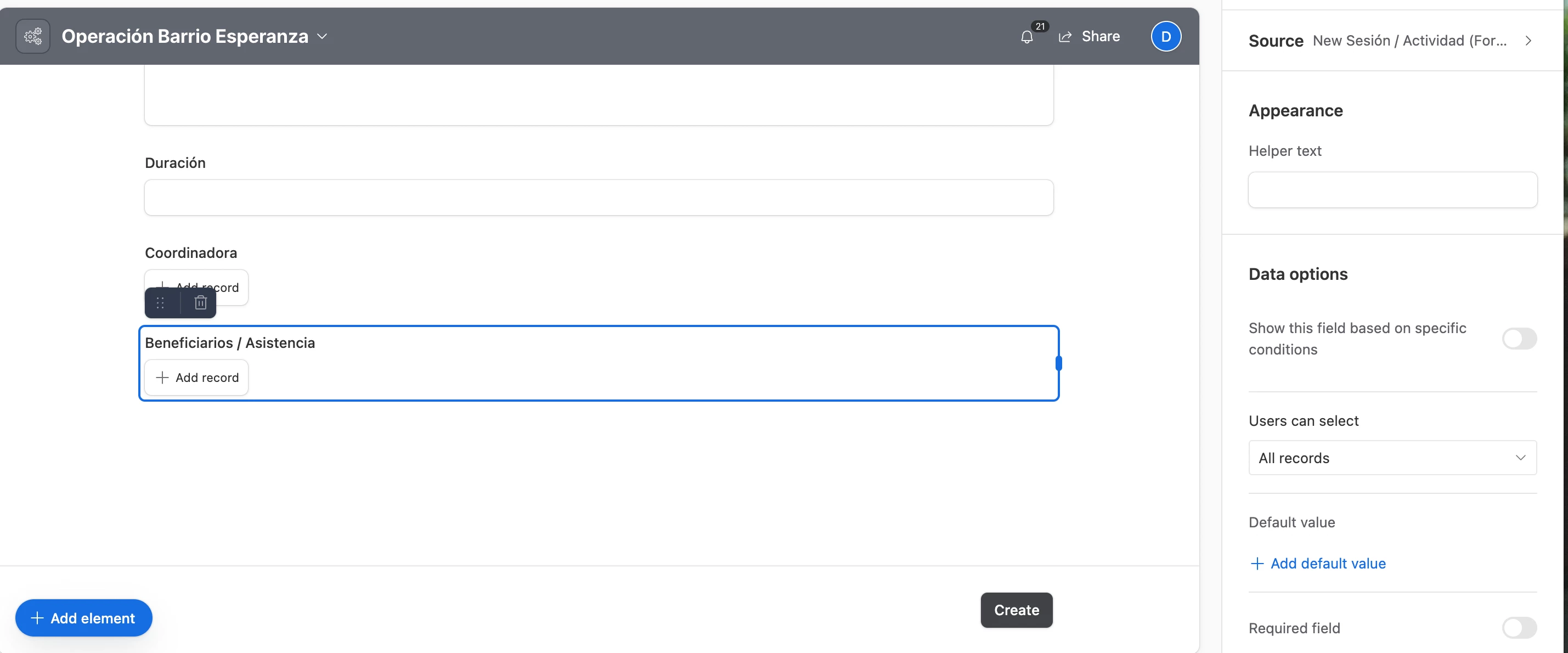

It still doesn't give me the option to add a new attendee or add any new record! Here is a video where you can also see that the forms view won't let me add new records. Only the grid view lets me add new records.
I'm desperate because I don't understand why it doesn't work, I must be missing something. I have the Pro license and I'm the creator of the base, I don't understand.

I'm ok with using interfaces and getting them a paid account (I prefer forms because we are a nonprofit) but ultimately I want to facilitate their work and that is super valuable to us. The problem is, that interfaces didn't work either. I tried the interface option and I still would not get the "add new record" option. I think there might be a settings option I'm not seeing.
If you know how to fix the interface solution. I would really appreciate it.

The permissions to allow users to create new records is on the right side. I made a movie that hopefully will help.
I don't have the "Permissions" section...
pressGO_design
That's because you're trying to use an interface form. You want to start with a blank canvas and use Record Picker and Field elements to get that functionality.
