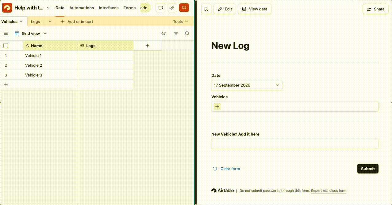

Yeap echoing what jills mentioned about two tables and I’ve set up an example here for you to check out
The idea is to have a table for all your Vehicles and another table to log them when they arrive
The form lets users select from the records in the Vehicles table, and if they can’t find the vehicle there, they can add a new one by filling in the ‘New Vehicle? Add it here’ field
When users fill up that field and submit the form, it triggers an automation that will:
  1. Create the new Vehicle record
  2. Link that new Vehicle record to the Log record

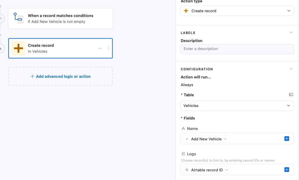

I am however still having a bit of trouble with the automation which creates a record in the “Arrivals” table. Is there a way to pull through the information captured on the form/”Log table”? All I get is a bunch of letter like so: reckDCaRinHHw9nLh. Ideally I would want to pull through the fields captured on the form/Log table and map them to correct fields on the “Vehicles” tab

Hm, could you provide some screenshots of your table and automation setup, specifically the Create Record step?

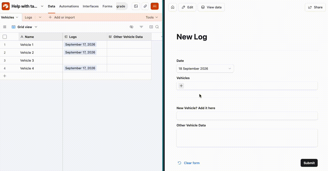

I've also updated the automation in the base to copy of the data in a new field called ‘Other Vehicle Data’ for your reference!
