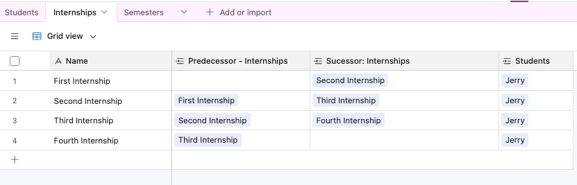

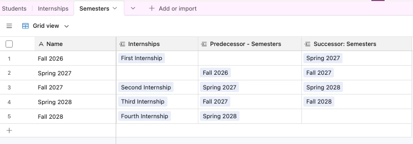

To set this up, we’ll first need to create a linked field in Semesters and set up the Predecessor information so that we know which semester comes after which:
After that, we’ll set up the same thing in the Internships table as well:

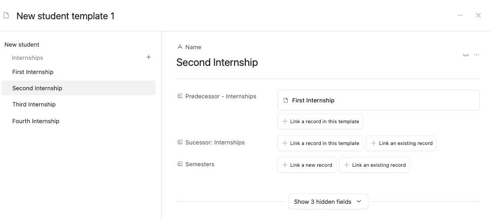

To easily create Internship records, I would recommend using Record Templates to do this

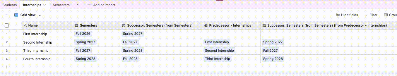

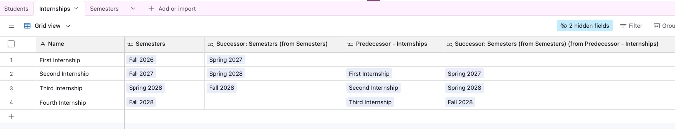

After that, we’ll need to create two lookup fields in Internships:
  1. A lookup field to display what the next semester would be
    1. From the Semesters table to display the ‘Successor: Semesters’ field
    2. Field name: Successor: Semesters (from Semesters)
  2. A lookup field to display what the next semester would be for the previous internship
    1. From the ‘Predecessor - Internships’ linked field, displaying the lookup field from the previous step
    2. Field name: ‘Successor: Semesters (from Semesters) (from Predecessor - Internships)’

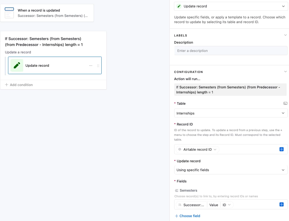

And finally, we set up the automation to trigger whenever ‘Successor: Semesters (from Semesters) (from Predecessor - Internships)’ updates, and its action will be to update the triggering record by pasting the new ‘Successor: Semesters (from Semesters) (from Predecessor - Internships)’ value into the ‘Semesters’ field
(I also put in a conditional to only run it when the field is populated, doesn’t need to be there but keeps the record history cleaner)
