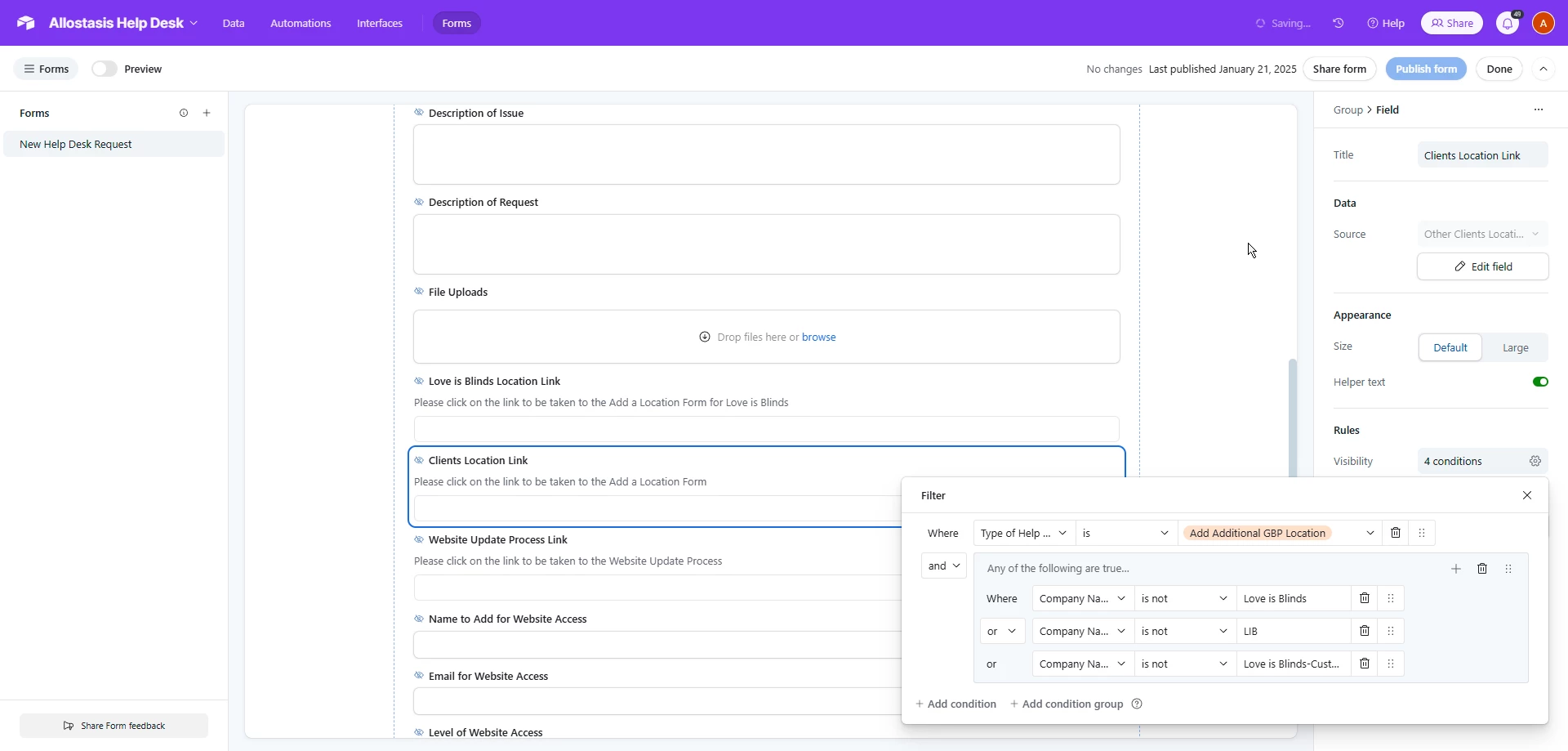

I have conditional visibility set for 2 fields in my form. One is working correctly, and the other is not. I  need to know what I am missing on the one that is not working correctly.

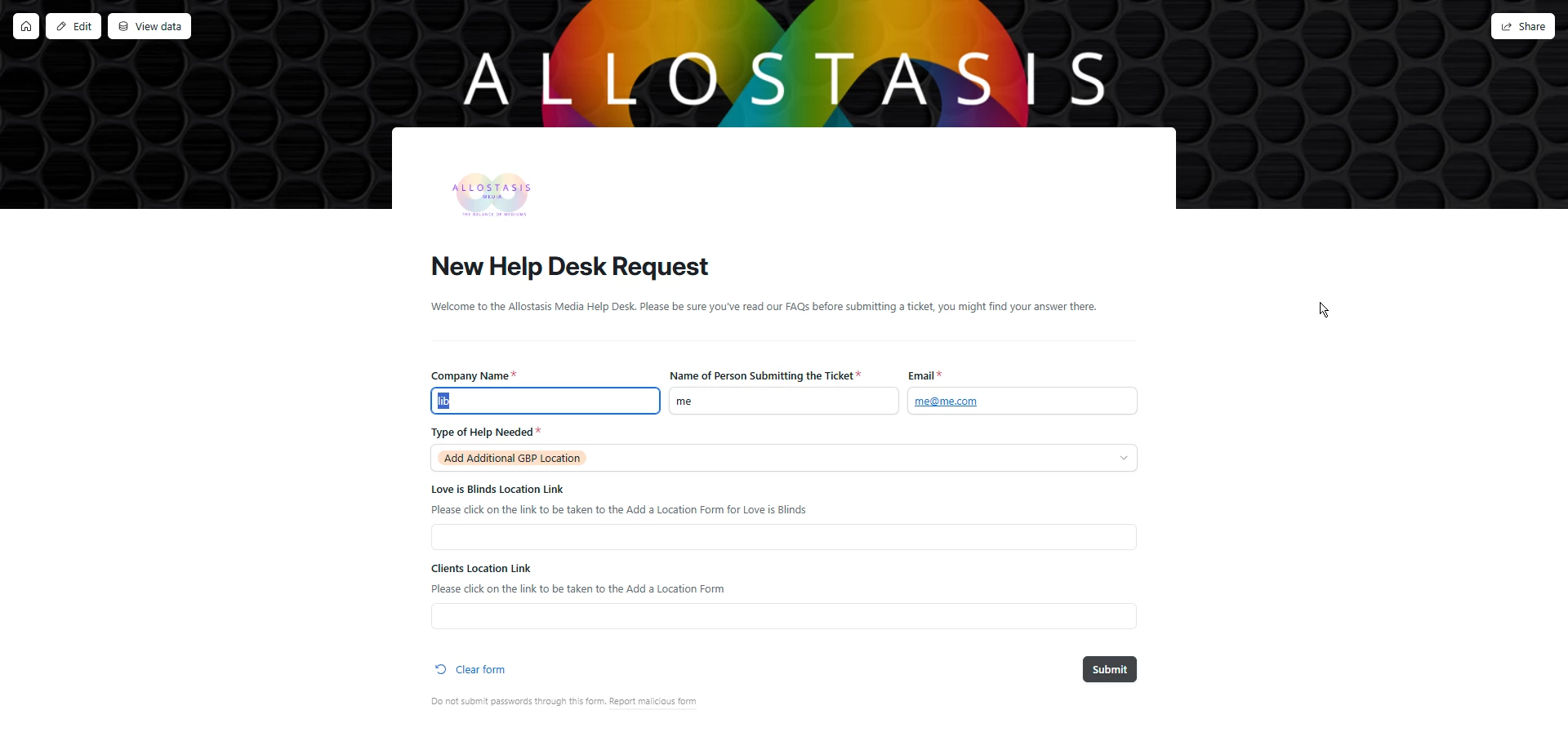

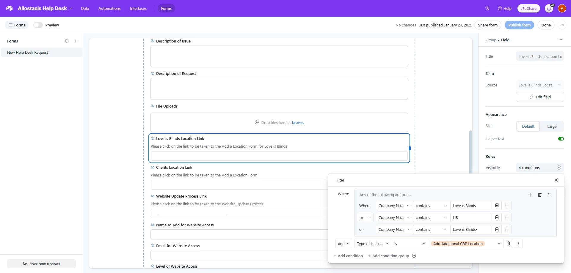

Here is the one that is working correctly as it is in the form and what the conditions are:

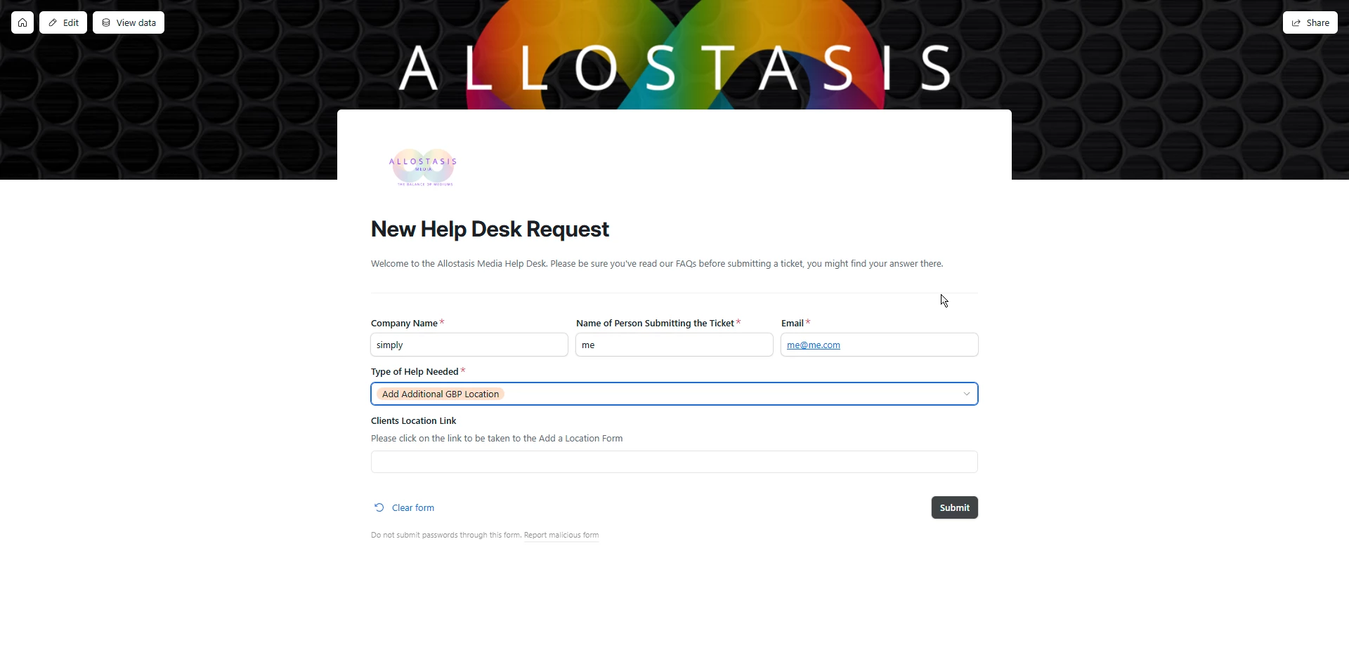

Here is the one that is not working correctly, as the Clients Location Link is still showing up when it should just  be the Love is Blinds Location Link:
 Any help would be appreciated.

Hello ! Two recommendations
1. Switch the condition group to read "and" instead of "or" for the LIB visibility filter
2. Airtable can sometimes be very sensitive - i see in your example is in lowercase, while the condition is in caps (LIB) - this may also be a factor
Let me know if this helps or if I can be of more assistance.

Thank you! I was able to get it to work as intended.
