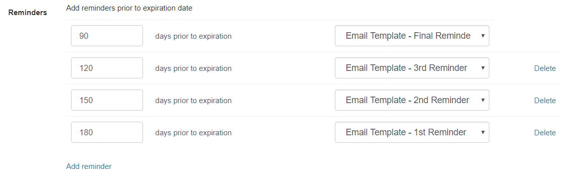

Our current software solution allows us to setup as many email notifications as possible as the expiration date nears. Each notification reminder can have its own specified days for the scheduled notification email to go out in addition to assigning a specific email template with customer subject line and content. Here’s what the settings look like in our current software.

  • I need the automation to run once daily checking each record for any products (records) nearing expiration at the intervals they are set to. The challenge is that not all suppliers will have the same intervals. Some might have 90, 120, 150, and 180 as notification intervals. Other suppliers may have 60, 90, 120, and 150.
  • I would still like to be able to use pre-written email templates coinciding with the specific intervals (ie. 90, 120, 150, 180) as each notification requires different actions that need to be taken by the recipient of the emails.
  • I’d like to be able to specify a different recipient for one or more of the emails. For example, have the first 3 notifications sent to one recipient and have the 4th one sent to another. The last notification requires a person with a different skillset than the recipient receiving the first 3.
