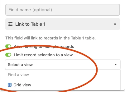

Hm, you’ve already limited the records available selection to a view?
  • May 20, 2022
Yes, i did that. After much searching i discovered that Jotform would allow values to be passed from one form field to another to facilitate a filtered drop down. I haven’t tried it yet

I was thinking that if your users are adding stories to the platform via a Form, you could achieve the above by doing the following:
  1. In the Platform Dates table, you have one view set up for each platform that will only display the dates for that platform
  2. In the form, you have a single select option field which allows the user to select the platform they want
  3. In the form, you have multipled linked fields, each one set to a different view. These are all set to be default hidden, and set to display only if the corresponding platform option is selected in the field we set up in step 2

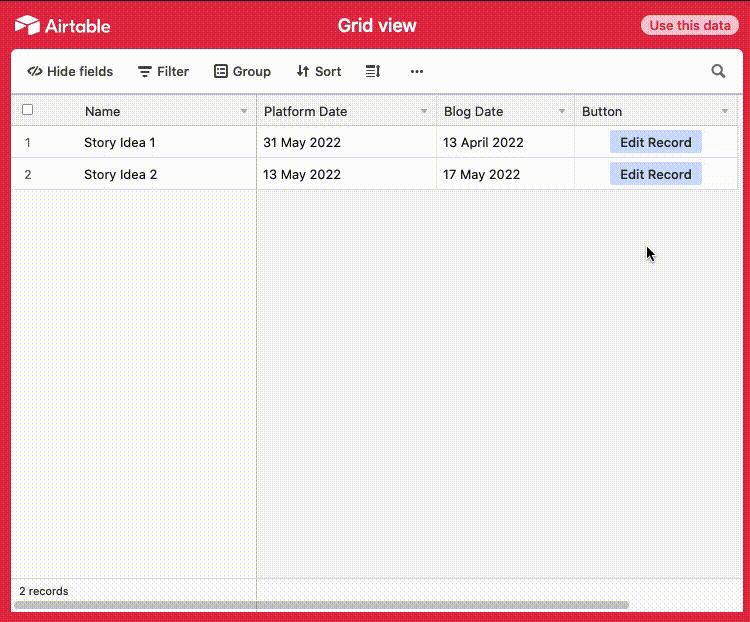

I’ve created option 3 for you here. You can duplicate the base via clicking the title of the base and then the three horizontal dots.
Even without duplicating it, you can test it out by going to this shared view link. When you click “Edit Record”, a new window will open with a Form prefilled with the record’s current data and the record automatically linked. All the user will have to do is modify the specific field they need to change.
On submission, the “Data” table will update automatically.
Here’s a gif of it working:
Let me know if you have any questions or if you would like to explore option 1 or 2
Thanks very much for these ideas!
On first read, I was a bit confused, so I need to have a proper look when I have time to get my head around this.
I also tried the demo link. It seemed to me that you would have to manually refresh the grid after making changes - is that correct?

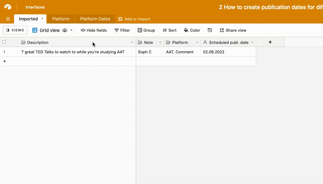

My problem is that I need to be able to bulk import stories in a CSV file) and create linked records for platform and date.
CSV file import doesn’t allow values in Linked Record fields.
Is there a way to do this with an automation? Maybe, creating an import table and then running a script from it to create records in the stories and platform dates tables?
Description Note Platform Scheduled publ. date
7 great TED Talks to watch to while you’re studying AAT Soph C AAT Comment 02.06.2022
8 things you can do while you’re studying to help you get a great job at the end Soph C AAT Comment 14.06.2022
I think I have a way to solve my user interface issue, without elaborate workarounds.
I link to a view with only recent/future dates, I can have users search for the platform name to pull up the options.
https://www.awesomescreenshot.com/video/9147495?key=b5594489fe53b74c85434d3490f6a382
I have a solution for platforms that require daily dates, but no need to go into that.

Hmm, in your CSV, is the data in the Platform column comma separated? So with reference to 7 great TED Talks to watch to while you’re studying AAT, is the text in the Platform column the following?
AAT, Comment
If it is (or if it isn’t but you can make it export like that), then we could just convert it into a linked field instead of having to resort to automations
