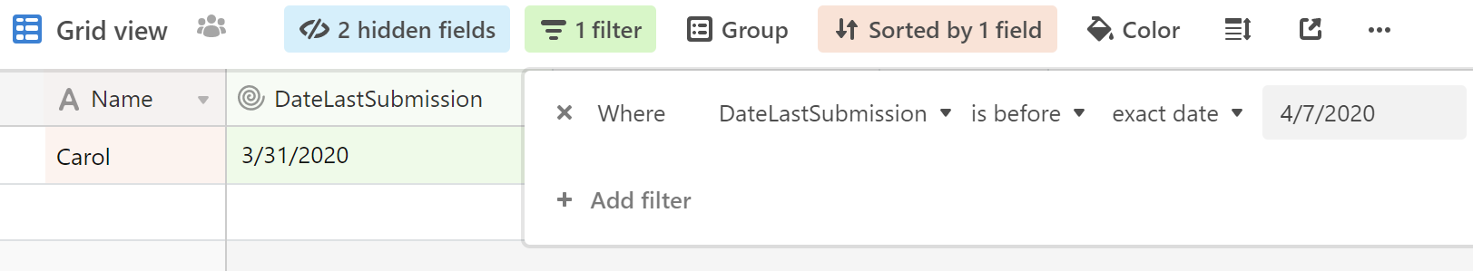

Auditing by reference to most recent date
Now you’re now just about home. To see who didn’t submit a form today, go to Employees and edit the Filters like this:
As you can see there, I have in my test base just 1 employee (Carol) whose most recent submission was before 4/7/2020 (which is today as I’m writing this).

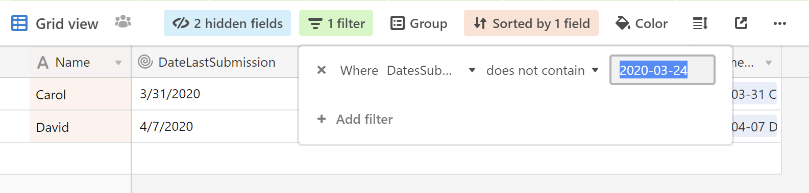

I’m assuming you’ll be checking daily or weekly as appropriate for your schedule. But what if you want to jump back a month or two and see who did not submit forms on some specific date, say, last month? That’s a little more complicated, but also doable. One way to do it would be to create a rollup field in Employees called DatesSubmitted. Have it rollup the DateSubmitted field in Timesheets and aggregate using this formula:
ARRAYJOIN(values)
The output will be a little funky: the values will look like this: “2020-03-31T00:00:00.000Z”. But that’s okay. Now if you want to know who didn’t submit a timesheet on 3/24/2020, you’d edit the filter to look like this:
Be sure to type the date in YYYY-MM-DD format for this filter. As you can see, in my tiny test data set, 2 employees didn’t submit timesheets on that date.
