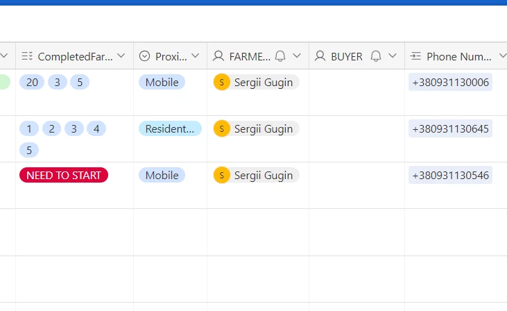

The community's help is really needed. I need to figure out access to certain rows in the database.
Scenario: Each row of the table has a "USER" field. In it I select users who have access to the table (screenshot #1). I want to make it so that "USER" see only those rows in which they are selected and can edit these rows. All other rows where they are not selected in the "USER" column, they either cannot edit or cannot see (it’s better if they don’t see it, but it’s not critical).

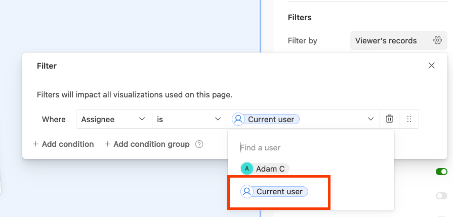

You can do this with an Interface by setting the filter to "Current User":

1. Your requested feature can be done at the interface layer, but not at the data layer (i.e. views).
2. You would set a filter for the interface page to only show the records for the current user.
3. Users cannot change that filter, as long as they are editors or below.
4. You would also need to remove the users’ base access, and only give them interface access.
5. Additionally, if you need more advanced user filtering or if you need filtering for customers (i.e. non-Airtable users), you can get that from external Airtable interfaces like Noloco’s advanced interfaces & portals for Airtable orJetAdmin’s portals & interfaces for Airtable.

But users can change the filter setting and see all other accounts. Am i right?
The filter setting is set for that element in the Interface, so if the user's viewing the Interface they can't change that filter setting.  If they've got permission to modify the setup of the Interface then they'd be able to modify the Interface and change that filter though
