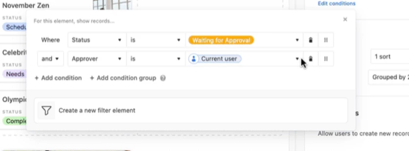

Hey Alfredo, you might be able to achieve this by using an interface that filters the records to "Current User."
