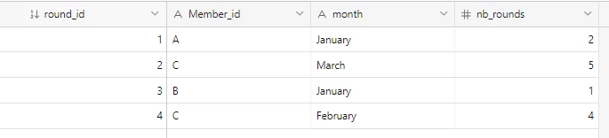

You should create a round table with its own key and "Member ID" as a text field to start with:
round_id in this example is an auto number.

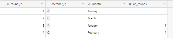

Once you have populated this table, you can modifiy "Member_ID" field type to link it to your Member table:

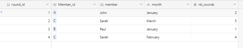

You will then have the possibility to add lookup fields as you wish:
