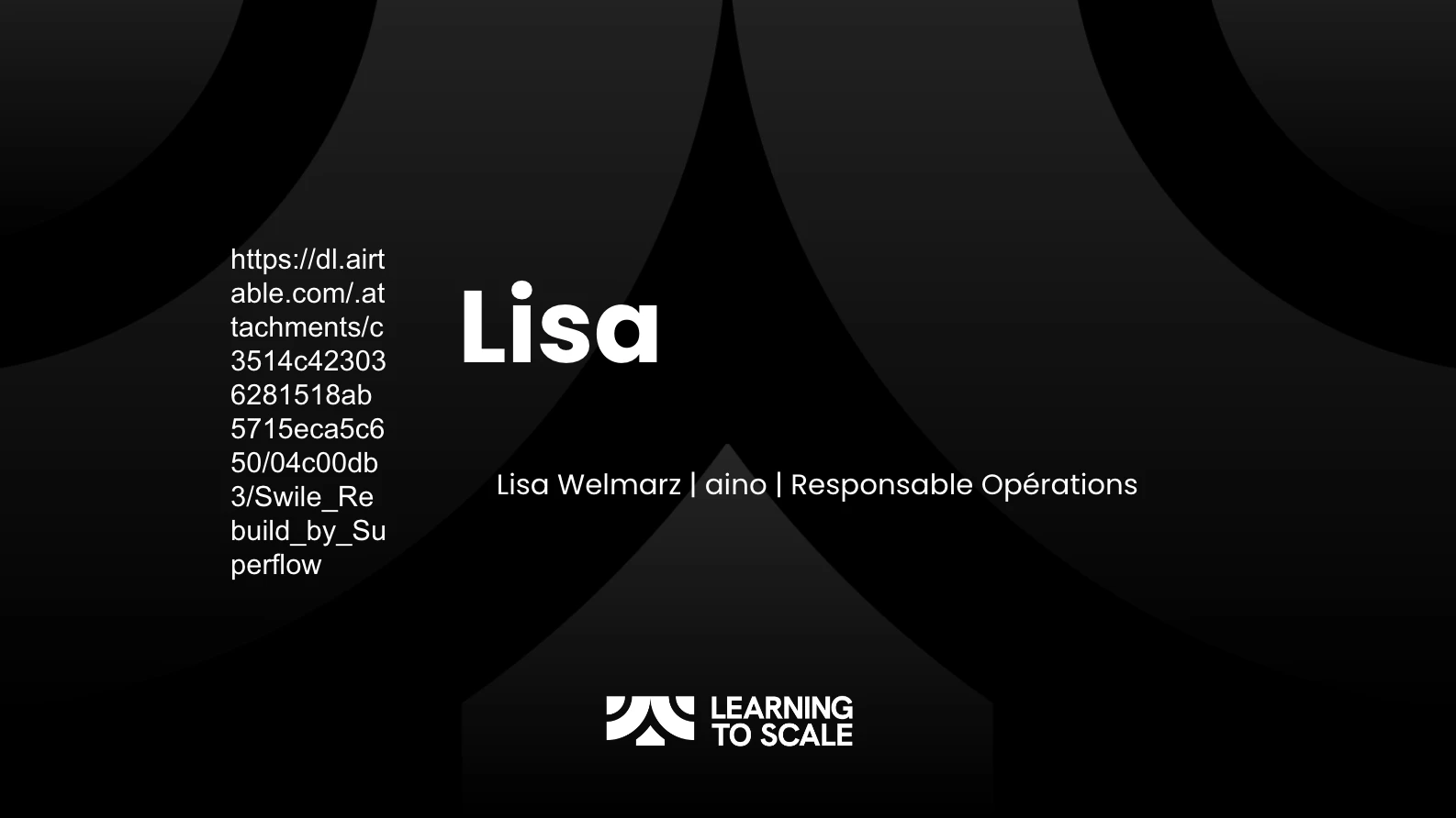

Since, every element is "transferred" on the Gslide presentation, but not the picture.
I have created a field with a formula to mimic the old link (like: https://dl.airtable.com/.attachments/c3514c423036281518ab5715eca5c650/04c00db3/Swile_Rebuild_by_Superflow) but it's not working.

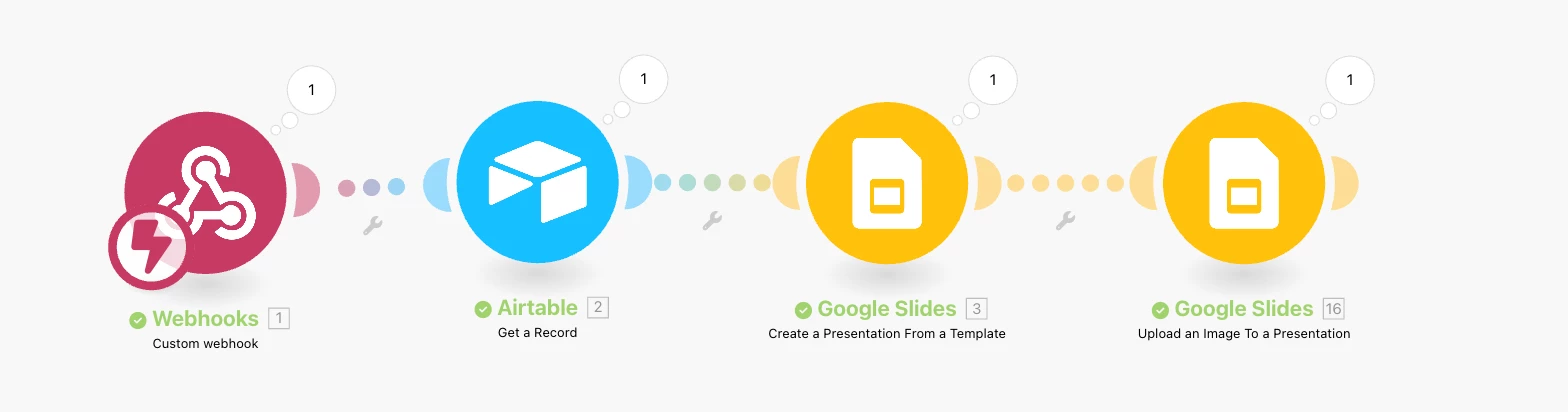

I'm attaching a screenshot of the scenario I created and the result presentation I get (so no picture, but the link of the formula).
