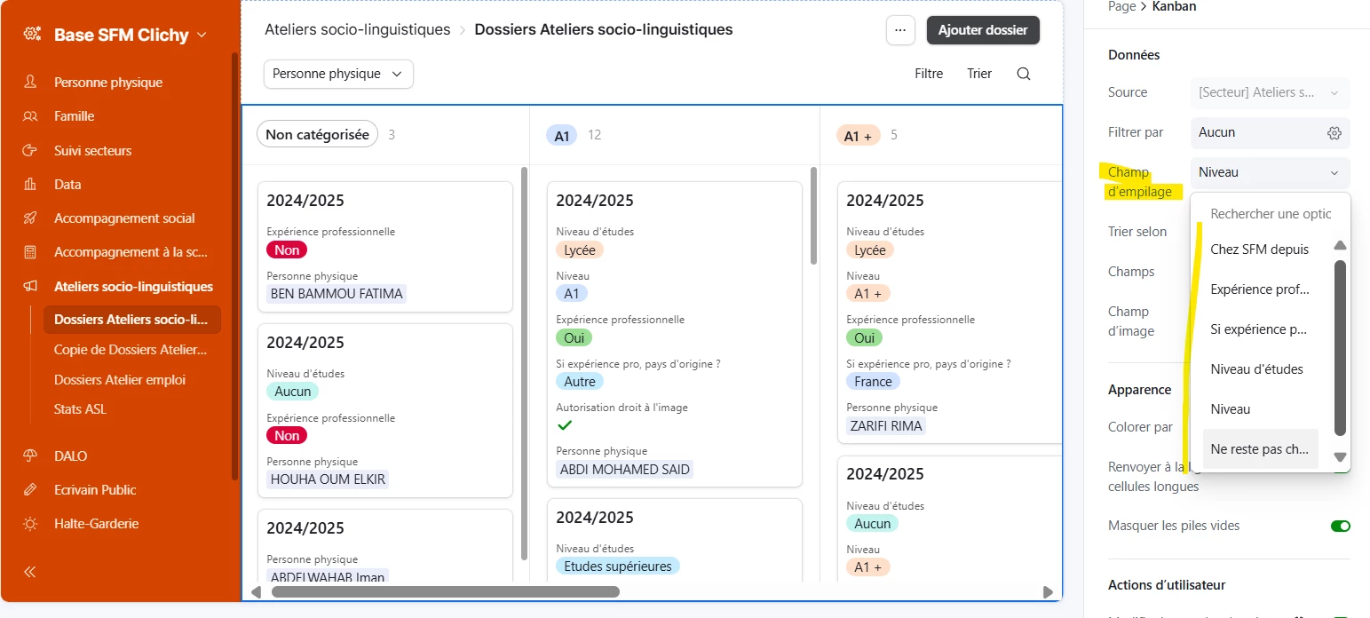

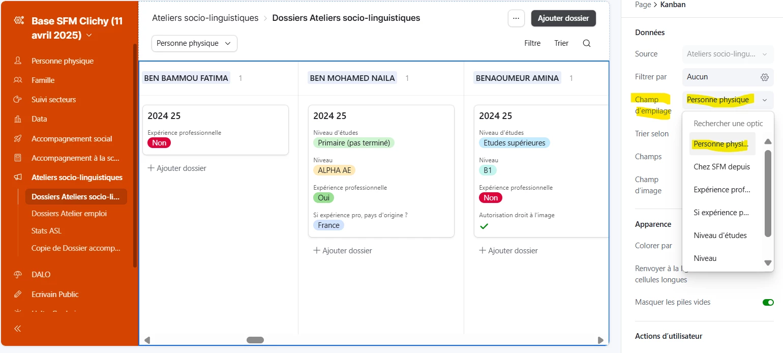

In the interface, for a specific sector, I had created a Kanban view where the stacking field was set to the ”person” :
“Person” stacking field is available
However, after changing the interface, I noticed that I could no longer select the "person" field as the stacking field.
“Person” stacking field doesn’t appear
I have tried to replicate the table from the older version but I can’t manage to make the “Person” stacking field appear again.
Could you please help me understand what might be causing this issue?

Best answer by Marino33
Found it : had to disable the “Allow linking to multiple records” option
  • April 28, 2025
