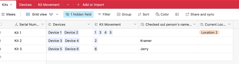

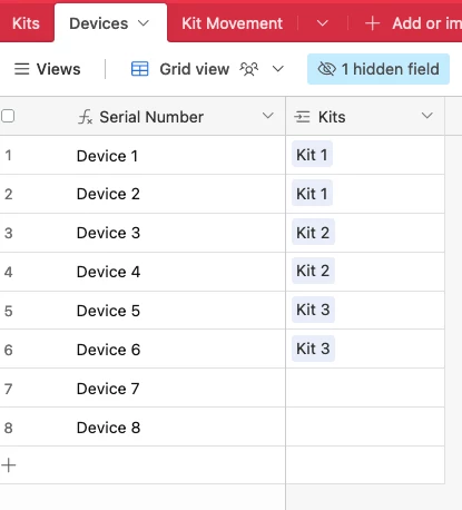

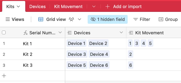

Here
So you'll have Kits:
Devices:
And movement:
And for display purposes you could use formula / rollup / lookup fields to see who currently has the kit or where it's currently located:

Here
Devices:
And movement:
This is really cool! Thank you so much for taking the time to show all this!
