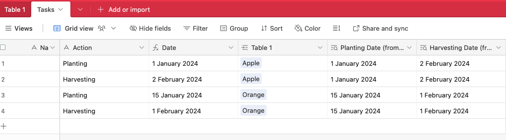

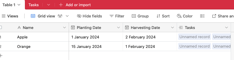

Hmm, you could try:
1. Create an automation that'll create X records every time a new record gets created in your original table, where X denotes the number of tasks, and each record will have the "Action" type set
2. Create a formula field that will output the appropriate date based on the "Action", with the data pulled via lookup fields
I'm not too sure what you mean about wanting the information to be dynamic though, sorry if I've misunderstood!

Hmm, you could try:

Thanks! I will look into it more!
