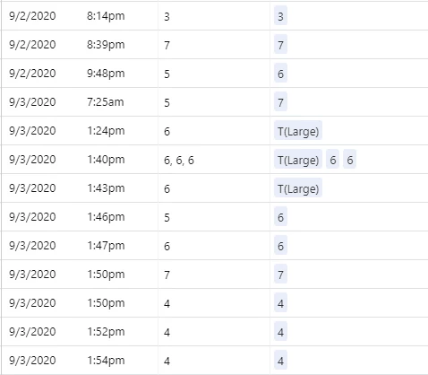

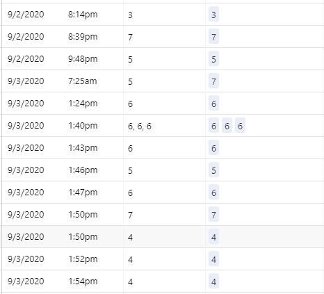

I run a diaper bank. We use AT to track requests for diapers by size. A text field tells us what size of diaper is being requested, and then, using a linked record field, we manually link it to another table that contains diaper sizes (diaper come in sizes Newborn, 1-7, and pullups). The text and links are easy to match. As of 12 hours ago, it looked like this:
(*Note: in the image above, the record created on 9/3/2020 7:25am is wrong (5 and 7). I’m not sure if that was human error, or the beginning of my problems with AT linked records. Keep reading for the main problem.)
However, this morning, the links for diaper sizes 5 and 6 went haywire. 5 turned into 6s, and 6s turned into pullups (which in the table we linked to, are called “T(Large)”. It now looks like this:
As you can see, some of the 5s turned into 6s, and some of the 6s turned into T(Large) pullups. Can anyone tell me why this happened? It’s severely messed up our inventory count. How do I fix it?

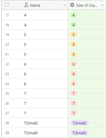

For reference, here’s a sample of what the table of diaper sizes looks like.

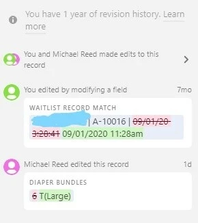

Thank you, that’s helpful! I can see the record’s history, so now I know when the change occurred, and that it came from one of my accounts. So far so good!
However, can you shed any light on why it happened? I know I didn’t manually go through and switch hundreds of linked records.
Further, I picked one of the changed records as a representative sample. In the record history it says that the linked record was changed one day ago… (see below, in the bottom part of the image)

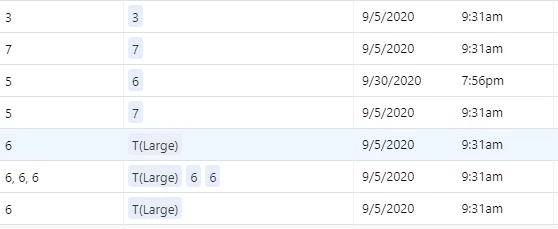

I went back and created a “Last Modified time” field for the linked record field, which tracks when the link record field was modified… in this case, “6” to “T(Large)”. I have highlighted the same record that I used in the image above. As you can see in the image below, “Last Modified Time” field says that nothing has changed in this linked record field since last September. Clearly, however, the records own history suggests a change was made yesterday.
Any ideas? I’m stumped! Thanks very much.
