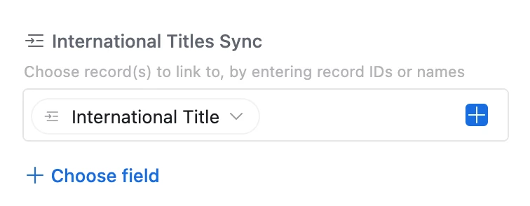

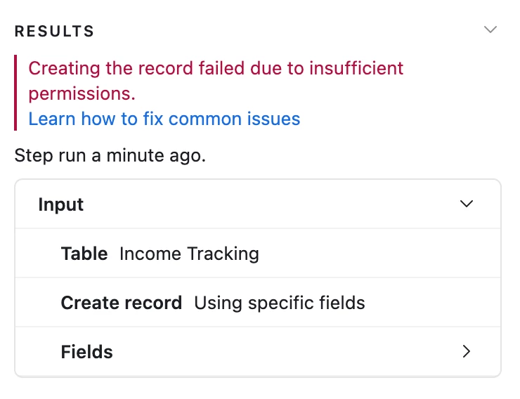

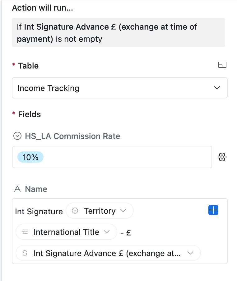

My issue is with the subsequent links. I can get the automation to work for each of the international/royalty and film/tv deals so they all appear when I add them in their related tables. But, the corresponding linked field is the issue so I can’t get it to update when the payment actually arrives - it tells me I don’t have sufficient permissions.
This section doesn’t have an issue.
But when I add this - which would pull through the ability to track when the payment came in with the tick box etc I get this….
I can go into the record and manually link it which pulls the data through so I’m fairly sure it’s to do with the automation but I don’t know what.
Any help gratefully received.
