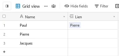

When building a simple base of entities (Let’s say Peter, Paul & Jack), i add a column to indicate there’s a link between two (or more) of them. Doing this, i use a Link to another Record in the same base.
So when i’m linking Paul to Peter, i see Peter in the “link” column of Paul.
But no link appears with Paul appearing in the Peter entry.
Is there a way to link two entries in a simple bidirectional way ? It sounds so pretty simple, i can’t believe i have to do it twice for each link between entries.
