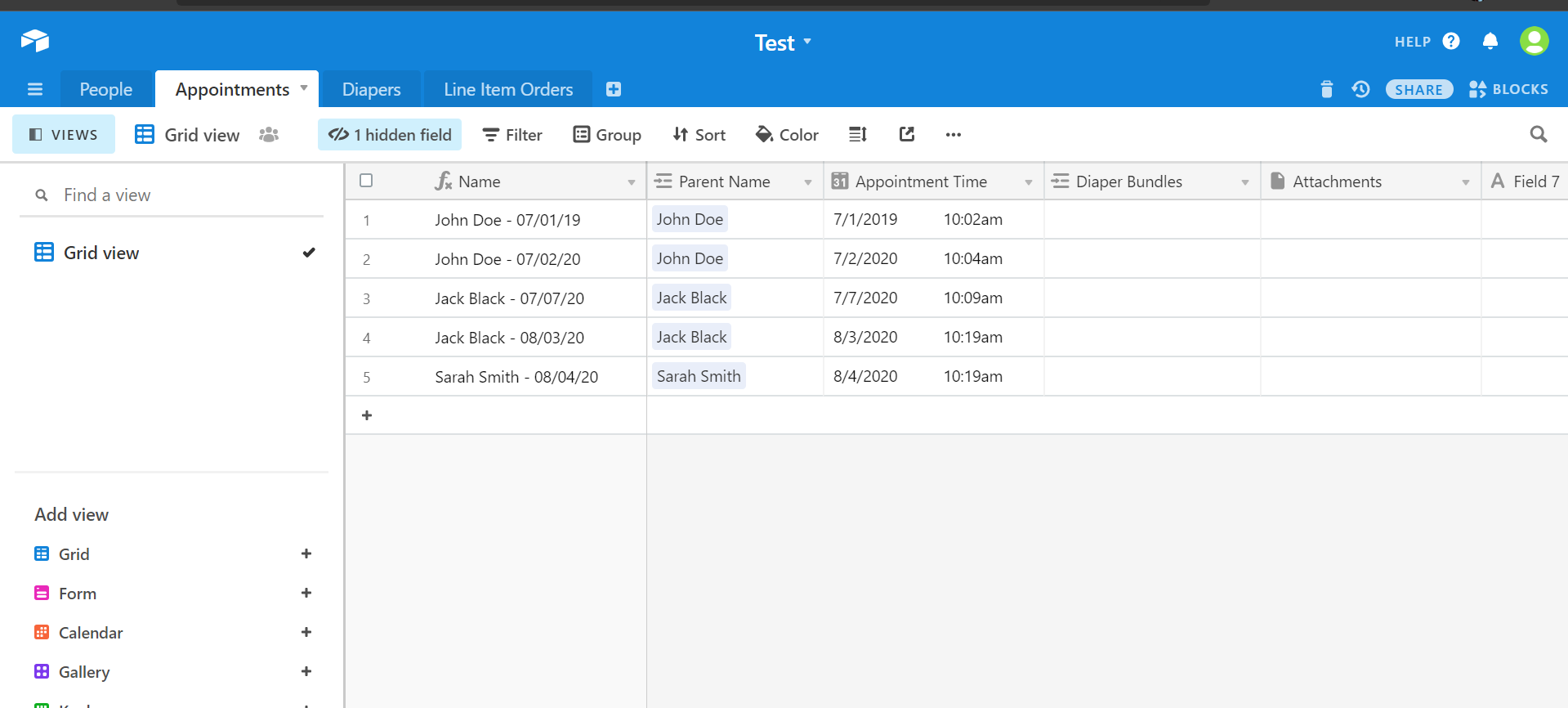

This is amazing! Thank you! I can’t believe I didn’t think of options 1 and 2. I think that did it!
I have one more question that goes beyond the scope of my original question. Do you have any tips about generating reports? I’ve taken your advice, and went with option 2, and then used a formula to run a count of the number of identical linked records in the [Diaper Bundles] field. (I.e. a count of how many bundles of each size per appointment).
Now I’d love to have an easy way to pull up stats based on different conditions. For example, how many bundles of each size did we give away in a given day, or month, or year. How many people attended in July 2020? Etc. Should I manage that by setting up different views, or blocks, or pivot tables? I’d love any advice.
Here’s a copy of my current Base, in case you’d like to take a look!
