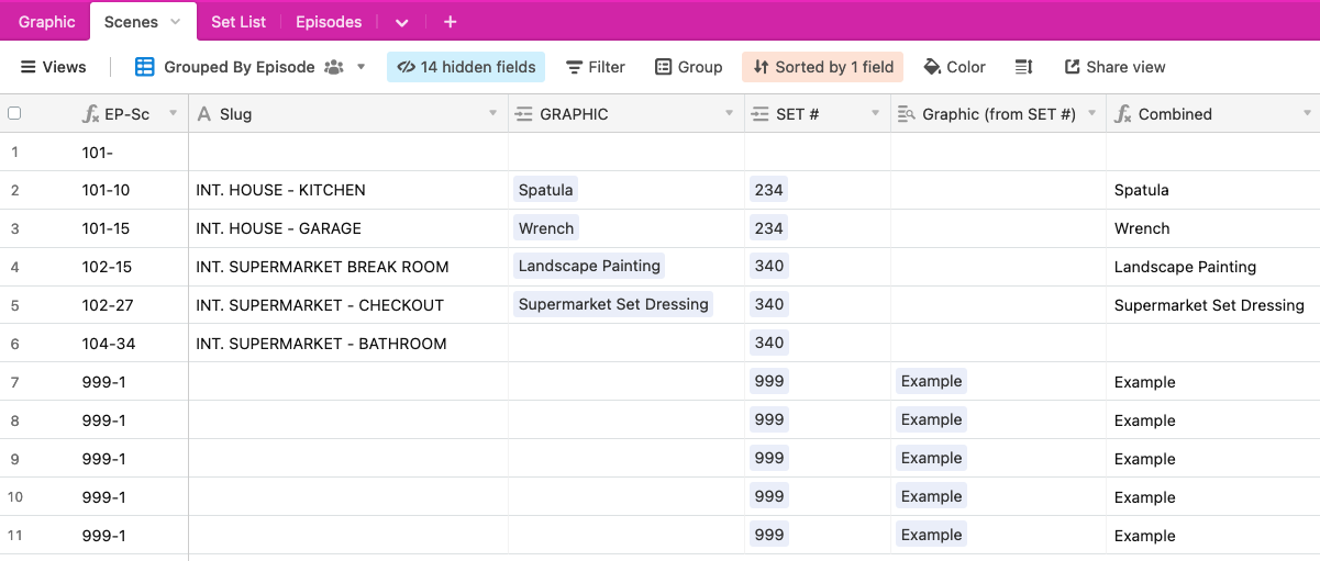

Hm if I were you I think I'd add a linked field to "Set" in the "Graphic" table actually, and in "Scenes" I'd add a lookup field from "Set List" for the linked graphic
You'd end up with two fields in "Scenes" that displayed the "Graphic" data, and you could use a formula field to combine the two:
Link to base
And if you didn't like how this looked and you wanted the "Scene" records to be linked to the "Graphic" records directly, you could add an automation at this point that triggered if the linked field to "Graphic" was empty and the lookup field was not empty, and its action would be to paste the value from the lookup field into the linked field, creating said link
You could also get rid of the link between "Graphic" and "Set" after the links to "Scene" are done via an automation as well!
