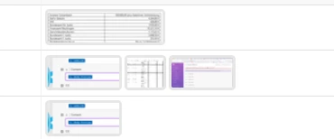

Hi guys. I made a connection with Make, so I can transfer every incoming email from certain accounts to a new data row in Airtable.
The problems are the attachments. I am showing you in the pictures below how I would like them to appear and how they actually appears. We need every attachment to be shown in a preview as a separate file.. The Make-support thinks it is Airtable-problem, so I am grateful for any suggestion.

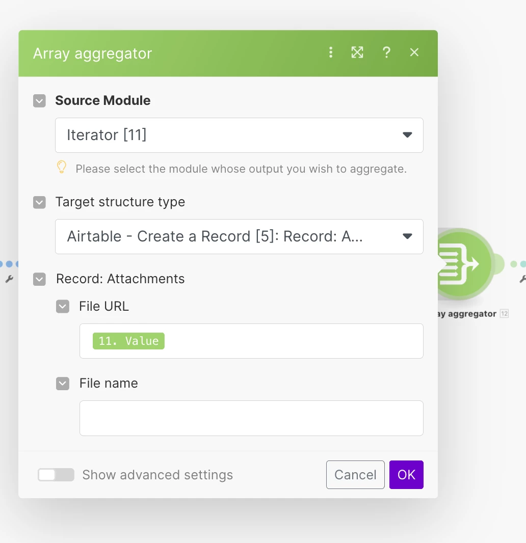

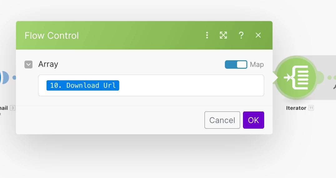

Maybe the problem is (see the picture bellow), the 'source' URL for the Iterator? I am really stucked, and spent a lot of times resolving this one and only problem.
https://eu2.make.com/290174/scenarios/666810/edit
Regards, Imelda
I’m glad the video helped you!
You’ll need to make sure that the URL for the image is (1) publicly accessible and (2) that it’s a link to the actual file itself, not a Dropbox wrapper page that encloses the image.
If the image is already publicly accessible, then you’re probably linking to the Dropbox wrapper page, not the image itself. You need to give the file path to the actual image itself, not Dropbox’s wrapper page.

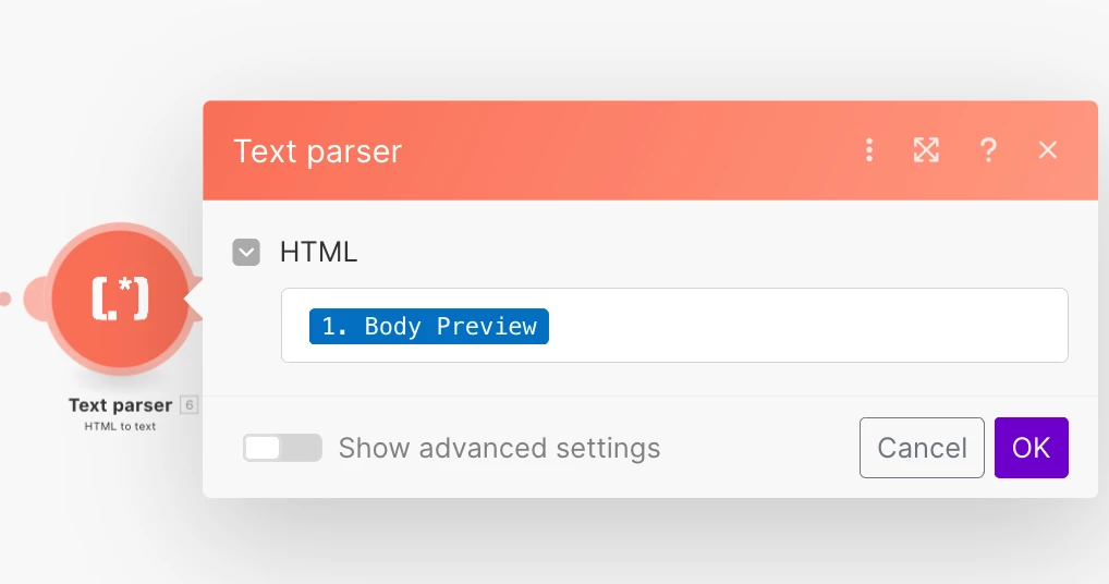

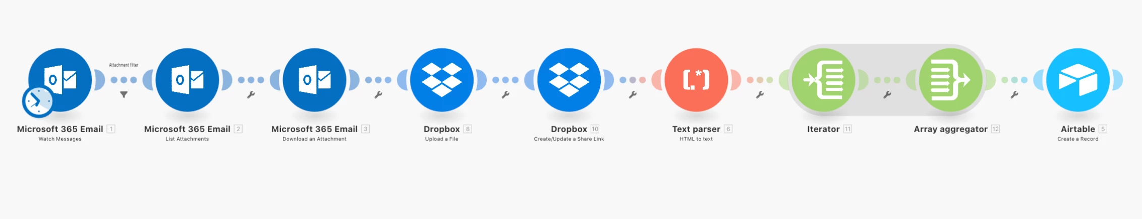

HI 🙂
Here are the screenshots:
Like I mentioned above, you are not using the proper URL. Your URL doesn't lead to any files — your URL leads to a Dropbox web page wrapper surrounding the image, which is not a file. Check out the Make's documentation at the bottom of this page for how to solve this: https://www.make.com/en/help/app/dropbox?pc=scottworld
HI 🙂
Thanks! That's an interesting setup.  Is that Text Parser parsing the download URLs from dropbox into a format the iterator can deal with or something?  The last time I tried using the "Upload a File" action for dropbox it only ever grabbed the first attachment in the email, so I have no idea how your set up's working hah.  It was Gmail though, so maybe there was a difference there
For what it's worth, I have a scenario that works with Gmail that grabs the attachment, uploads it into dropbox, and then uses the download URL to upload it into Airtable successfully, and the preview shows up fine, so on a technical level it's totally doable I guess.
I think if I had multiple attachments I'd put the iterator right after the watch email action and then run the actions on each attachment, i.e. upload each attachment, create the share link, and then use the aggregator on all the share links, then have the Airtable create record action after
