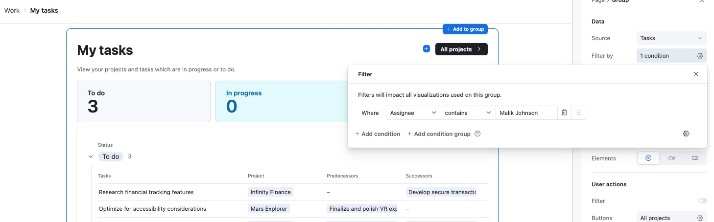

It’s this template, is that right?
https://www.airtable.com/templates/project-management/expnPwND0WA2x7nhJ
If so, the ‘My Tasks’ section has a filter for ‘Malik Johnson’:
To get this to work properly (filtering to show each the logged in person’s tasks), we’d want to update the base to filter the records based on ‘Current user’s email’ instead, and I’ve set it up here for you to check out
The idea is that we’ll need to:
  1. Create an ‘Email’ field in the ‘People’ table
  2. In the ‘Tasks’ table, create a lookup field to display the email
  3. Filter this group based on the current user’s email
If this isn’t the right template, if you could provide a link to the one you’re working on that’d be helpful!
