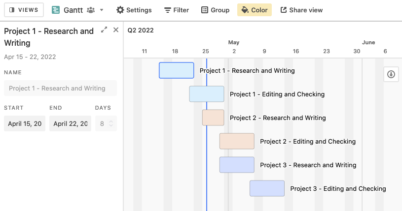

I thought it would be best if you used a Gantt chart as well, but your workflow involves having the Start, Draft and Delivery dates in the same record, whereas the Gantt view expects to have a single “Start” and “End” date
To solve that, I did the following:
  1. Created a “Gantt” table
  2. Created an automation that, on the creation of a record in the “Research Projects” table would create two new records in the “Gantt” table
  3. Set up the fields in the Gantt table to generate the Start and End dates as needed, which resulted in the following:
For the setup details of step 2 and 3, do check out the example base linked above; you should be able to duplicate it and view the automation and the field formulas I used!

With that in mind, I think in your position I would do the following:
  1. With the example base in mind, separate each phase into a single table (which is what you already have now, I believe), as it seems like there is a lot of information, besides date information, that needs to be organized for each phase
  2. Using the same logic as the automation from the example base, create a record in the Gantt table for each sub-phase, allowing you to view everything via the Gantt table
I think this would work as, once the automation has created said records and they’re linked, you can update them easily and you can add logic to the Gantt table to customize it to what you want to see.
I feel like having multiple records with two date fields would be a cleaner solution in terms of data display / linking, but if business needs allowed you to, you would already be doing that, and I’m not sure what those business needs are that are preventing this
