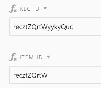

Here’s an option that Kamille created
You could also use a formula field to generate a unique code for each item. You could use the Record ID and then use another formula field to extract out a portion of the Record ID as your item ID.
