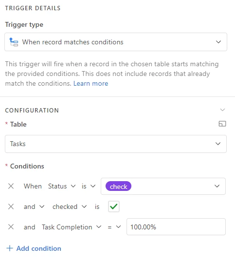

Hm I think so.  Your automation would trigger once the "Status" was set to done and it would have a "Create record" action

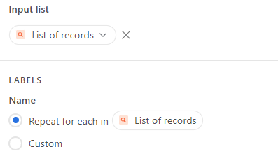

For the subtasks, you would use repeating group functionality and create one record per subtask record linked to the triggering record
