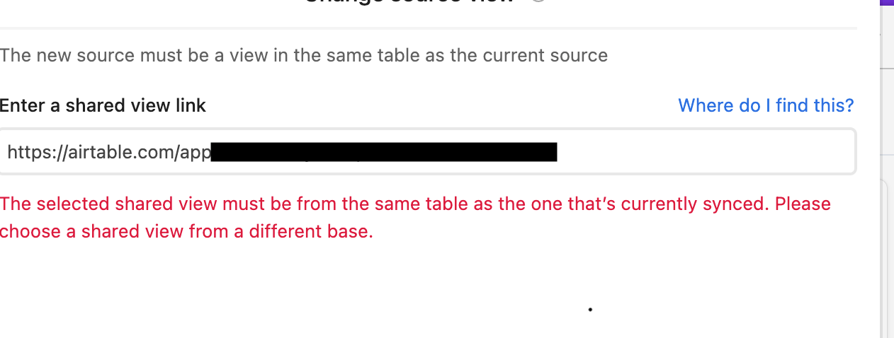

I made a massive mistake when doing some updates to a base, so I figured I'd restore a snap shot. I created a snapshot copy of the base, and deleted the original. This has just compounded my issue because all my data syncing to other bases is totally messed up. This also impacts several automations i've created to work around the fact that my company wont shell out for two way sync features.
What a headache.
It seems to me this wouldn't be an issue if I were able change the source link to my sync set up to the snapshot base, but alas I get the following error.
HELP!!!!

How long time ago you are deleted the original? You can restore deleted base from Workspace Trash by clicking on account (upper right corner on home page) menu and choose 'Trash' above 'Log out'. I guess you should rename current active base (created from snapshot).
Then just copy paste correct info from snapshot to the table where mistakes were made.
I don't know if the sync will be restored, maybe it needs to go and click to make it active again.
