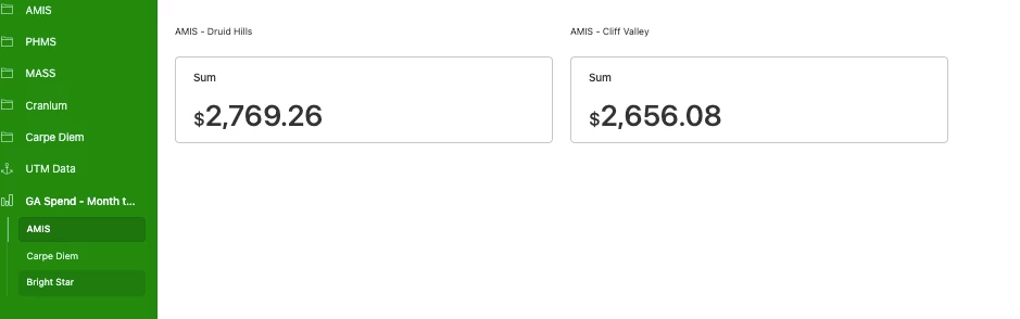

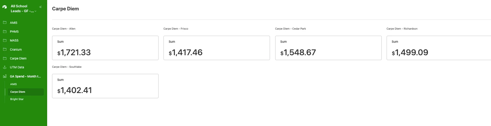

Similar solution with the interfaces… you can create just one interface page that you filter to show you what you’d like to see.

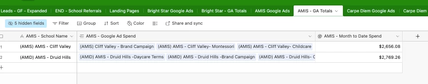

School A Table has Columns which has another column with a roll up.
I want to duplicate this with a script for School B, which has no relation.
I would imagine there is some script that would duplicate everything and rename columns. (School A) to (School B).

Some clarification. School A has a main table with data, an additional table with linked fields, and a rollup, in which Google ads feed data to the main table. Maybe I am too ambitious, but I wanted to load everything again for a second school, so I just had to feed in the data. When I duplicate, I have to connect the fields and roll-ups again.
