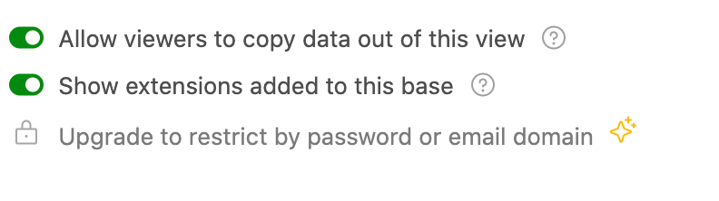

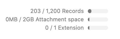

I've got a base (with 2 script extensions) which I share publicly and with all sharing options (copy data & extensions) enabled. The base is also not over it's extension limit in the workspace.
Problem

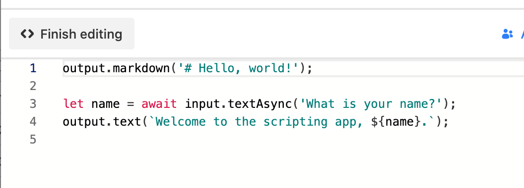

When another user accesses this shared link and copy it to his/her workspace, the 2 scripts are there but their code is overwritten/removed with the default 'hello world' script.

Best answer by kuovonne
Have you turned on the toggle to include scripts in shared copies of the base in the “advanced” section of the editor?
You're my savior for today, thank you so much! That's a lot of clicking in sub menu's to found one toggle haha.
