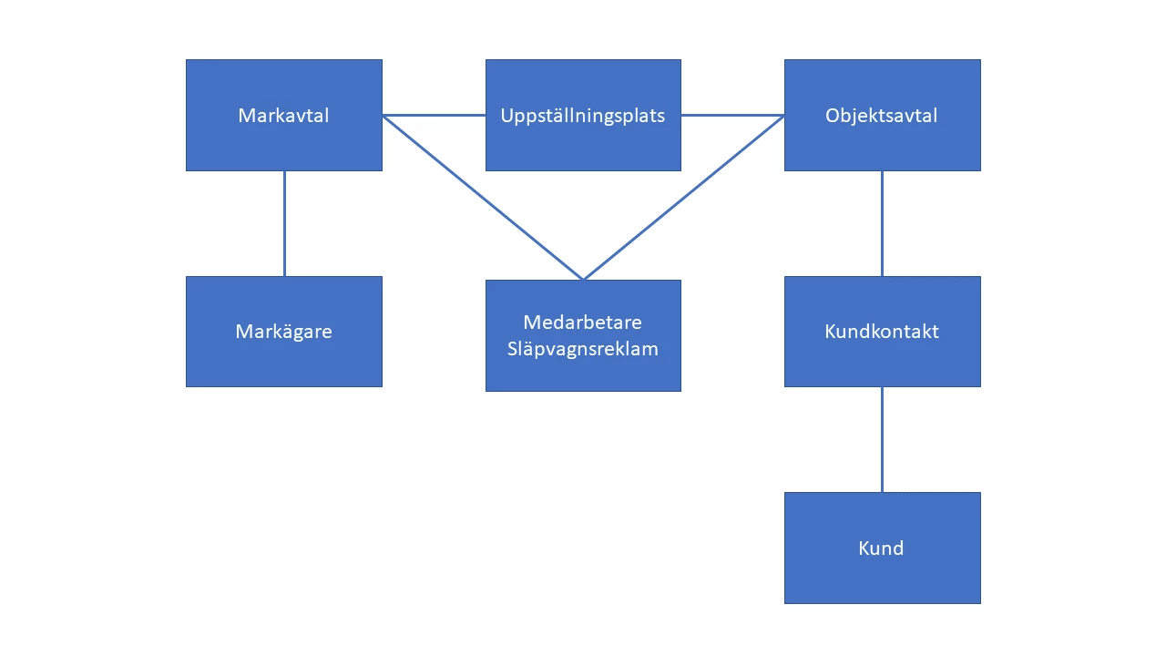

Hi!
I’ve attached my table connections as an image. Is it possible to to show “Kund” in the table “Uppställningsplats”? If not, what’s an alternative set up?
Thanks!
Thanks, but you can’t do look ups of look ups. Right?
You can, a Lookup field can “lookup” any other field type including other lookups.
Kamille_Parks11
Forum|alt.badge.img+27
The Objektsavtal table would have a lookup of the Kundkontakt table’s connected Kund records, and the Uppställningsplats table would have a lookup of that lookup field in the Objektsavtal table.
  • September 2, 2021
Kamille_Parks11
  • September 2, 2021
Hmm… I’ll have to go back and see why I couldn’t make that work.
  • September 2, 2021
Turns out you are correct and my problem is gone! :slightly_smiling_face: I just had to tweak a few things.
Thanks!
