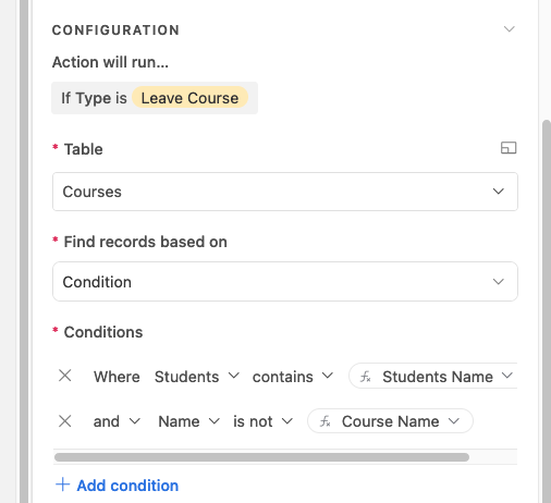

> I looked into that, but I can't find a way to have Airtable automations simply unlink specific records in a multi-linked-record field without using scripts, and coding scripts is...intimidating. The best I can do is having an Airtable automation overwrite the field entirely.
Hm, I don't think you'll need scripting for this actually.  Just set up an automation that'll look for all the courses that the student is signed up for AND the course name doesn't match the course they're leaving:
And then update the Student record's "Courses" linked field with the found value
Forum|alt.badge.img+8
Well I'll be. That is a fantastic solution; thanks, Adam!
