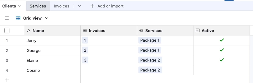

The idea is to have an ‘Invoices’ table where each record represents a single Invoice to a Client.  Then we can populate it with an automation that runs once a month that looks for all of the active Clients, and for each of them, create one Invoice record:

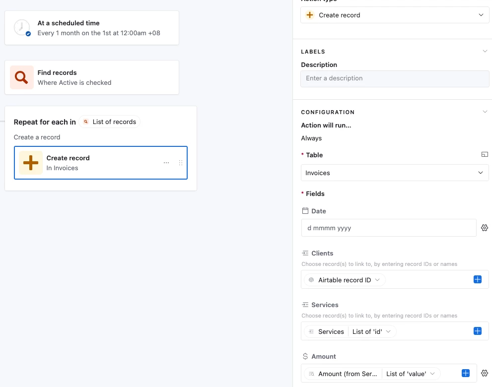

And here’s the automation setup:
This way if we update the pricing of one of the Services it won’t affect any of the previous Invoices, does that make sense?

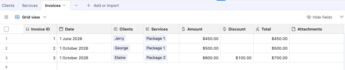

The ‘Invoices’ table would also have a field to let us key in Discounts, with a ‘Total’ formula field that outputs final value
