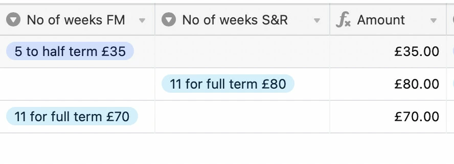

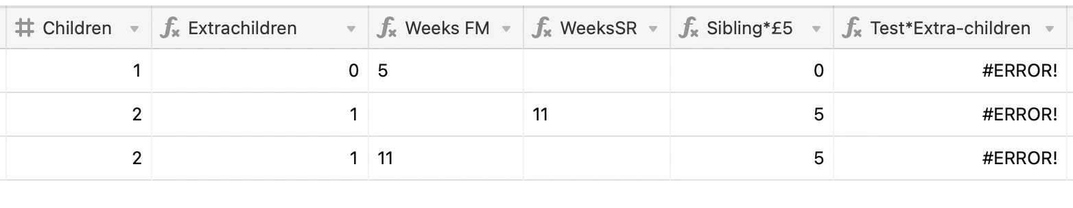

I have a formula that correctly shows the cost of having 1 child in a class. When the parent has 2 or more children the cost is £5 per extra child per week.
They could be in either Weeks FM or WeeksSR.
So far I have a column showing “extraChildren” / number of weeks /class fm/ class sr/ but my formula is wrong and I have no idea what it should be.
Once I have the correct total I will need to add that to the combined Total Amount
The Amount formula is already very complex so how would I add it.IF({No of weeks FM}, VALUE(RIGHT({No of weeks FM}, LEN({No of weeks FM})- FIND(“£”, {No of weeks FM}))), 0)+IF({Zoom}, VALUE(RIGHT({Zoom}, LEN({Zoom})- FIND(“£”, {Zoom}))),0)+IF({Party}, VALUE(RIGHT({Party}, LEN({Party})- FIND(“£”, {Party}))), 0)+IF({No of weeks S&R}, VALUE(RIGHT({No of weeks S&R}, LEN({No of weeks S&R})- FIND(“£”, {No of weeks S&R}))), 0)
Any help you can give me on this would be greatly appreciated as no matter what I read about formula, I am afraid I can’t seem to follow the logic.

Philip, try using the following for your extra children calculation…
Extrachildren * ({Weeks FM} + {WeeksSR}) * 5
I left out anything about your Sibling*£5 column.
You could create a new field that adds the above to your current “Amount” field, to get a Total. Or, you could add the above to your Amount field with a “+” before the add’l part of the formula.
Does that work?

Firstly thank you so much for your input.
I have literally spent all day today, watching Airtable videos and support files but came nowhere near your solution which certainly totals correctly.
I have tried to add it to the Amount formula but failed so far.
I will try again in the morning but I have to confess to being very tired now.
Should the “+”{Total for Extra-children} be at the front or the end of the existing formula and should there be additional brackets?
I can’t tell you how much I appreciate your help.
Thank you Phil

You’re welcome Philip. Leave the curly braces around the field name, but take the double quotes away from the + sign. Leaving it at the end is fine.
