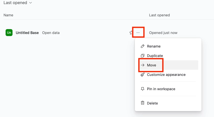

Yeap get them to invite you to their Workspace and just transfer the Base into their Workspace
Automations will transfer over fine, Fillout form works fine after transfer, and your Make automations that are getting triggered via webhooks will be fine too
