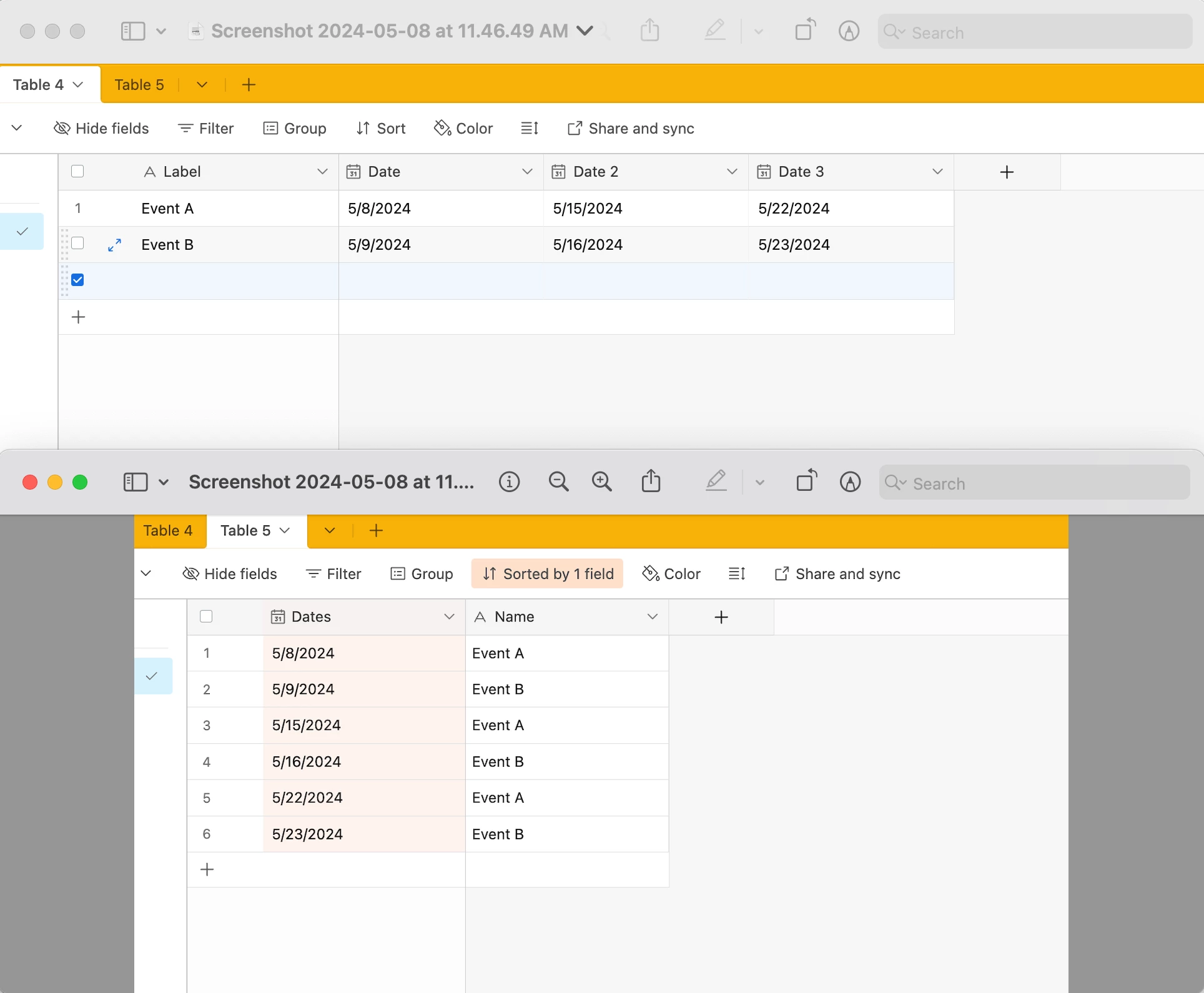

Hello everyone,
I want to create a linked table that shows columns in one table as rows in another table.
I looked at Pivot functionality, but it seems to be designed for Interfaces. (I didn't try it yet, so I could be wrong here)
What I'm looking to do should be fairly simple: check the screenshots.
Dates in Table 4  should be automatically transposed to how they look in Table 5.
In the screenshot I did it manually for demonstration purposes.
Thanks!

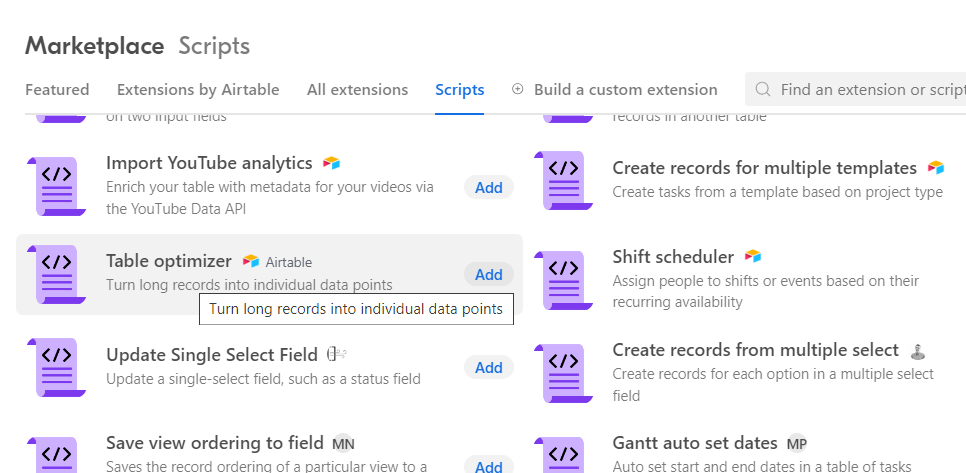

I just remembered - Actually Yes, Airtable has the script in example scripts capable of doing the similar thing. It's input settings were not convenient for me, but the source code was extremely useful when I learned JS in Airtable and what is object/array and how to work with them to read and write data in tables.
You can try it as well, maybe my feeling about settings biased in the favor of my code 🙂
