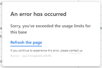

I have a weird issue that I cannot find more information on. This is popping every time I try to input new option to my multiselect field. I do not believe I reached number limit (I'm on pro subscription). Appreciate if anyone know what this is 😞 Error: pgl4I6ngheDLjVwFb

No idea why you are seeing this error.
How many existing select options do you have for that field?
How many records do you have in the base?
Are you able to make other schema changes to other fields?
Do you have an automation watching this field for changes? You might have hit your monthly automation run limit per your billing plan.
  • May 31, 2023
Thanks for the support guys, I appreciate it. I discovered that I have exceeded 10.000 options for multiselect field resulting in the error mentioned. I need to use the field more sparingly...
